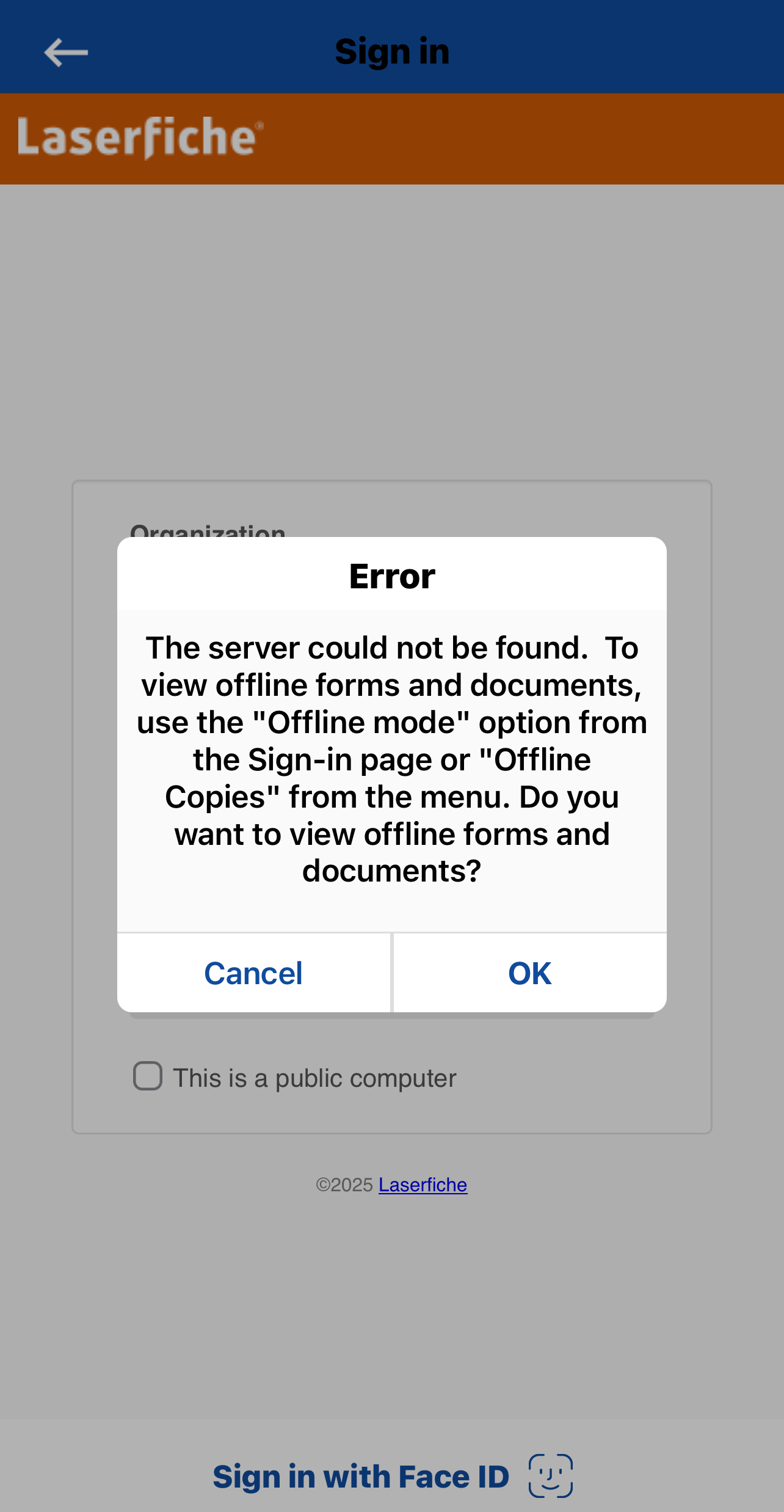

I'm wondering if there's a way, perhaps in the IIS console or somewhere else, to keep this error from displaying on the mobile app (I have attached a screenshot as well)
Error
The server could not be found. To view offline forms and documents, use the 'Offline mode" option from the Sign-in page or "Offline Copies" from the menu. Do you want to view offline forms and documents?
This error shows every time the app is signed into. The server is accessible, though! We can just click cancel on this error message every time and it lets us sign in just fine.
We can't seem to pinpoint any of our particular firewall rules or group policies to keep the error from displaying.
I'm thinking that the error is showing because the app just isn't giving it enough time to find the server. So if it doesn't find the server within a half a second, it thinks there's no server and displays the error.
So I'm at the point where I'd like to see if I can just turn the error off altogether, since we never actually have server connection issues.
Thanks in Advance!

Alright so I tried these steps and what I found was that the error occurs with both. It occurs when I only have the Repository added, and it also occurs when I only have Forms added. I'm guessing the error is happening during the first initial reach out from the mobile device to the server that mobile is installed on.
We still haven't found any network related reasons why this error might be occurring. We've been using mobile since last summer and this just started happening maybe a month ago.

I've attached a screen recording of the app when I open it.
I can't really even test your number 1 because the error happens immediately upon opening the app.
This happens regardless if we're on a company iPad or on a person device (the attached video is from my personal iPhone)
I did open a case with Laserfiche (Case 242687) and sent them all of the event logs from the server where Mobile is installed.
They basically concluded that this is a networking issue and not a LF issue, so they just closed the case and said they cannot help. We cannot find anything network or group policy related that would cause this error. I wasn't sure where to go next so I put this question on the LF Answers site.
Again, the app signs in just fine despite this error popping up all the time. It's like it pops up and the app signs us in fine anyways behind the error.
replied on January 15
I'll also add that I only get this error when the mobile URL is filled in. If I clear it out, the app does not show any errors.
