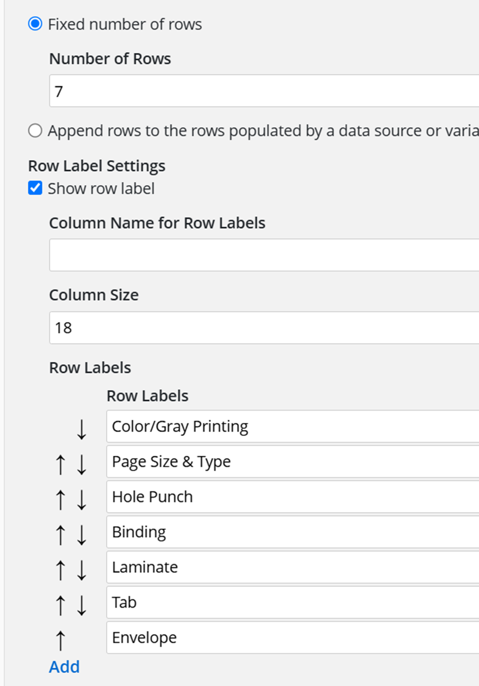

replied on December 10, 2024
Hello,
To clarify, I have a table with Fixed number of rows.  How do I reference to each row, say Binding, for I don't see the fieldID's in the Layout.  FieldID:52, I think, is referenced to the column?

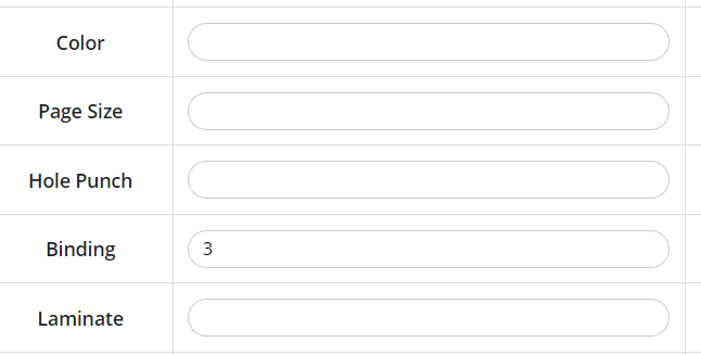

If you are assigning a specific value to each row you can use:
LFForm.setFieldValues({fieldId: 52}, ["1", "2", "3", "4", "5", "6", "7"]);
Just change out the values you are using.
You can also use the Index
LFForm.setFieldValues({fieldId: 51, index: 3}, "3");
Adjust the index value for the row you are assigning a value to.  The row will start at 0.

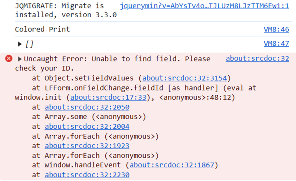

Here's my codes:
LFForm.onFieldChange(function(){
  if (LFForm.getFieldValues({fieldId:32}) == 1)
    console.log('Colored Print');
    console.log(LFForm.getFieldValues({fieldID:52,index:0}));
    LFForm.setFieldValues({fieldID:52,index:0},"0.3000");
  else
    console.log('Grayscale Print');
}, {fieldId: 32});

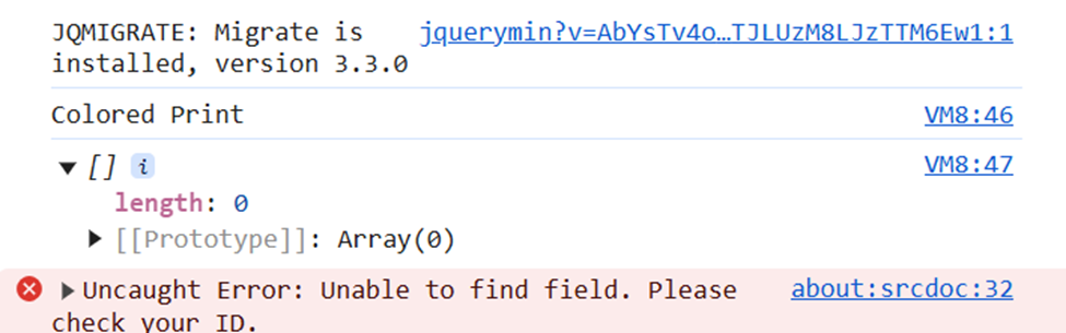

Also, seems like the array is empty, not sure why.  There are 7 rows.
There's a typo on my end.  Should be {fieldId... not {fieldID
