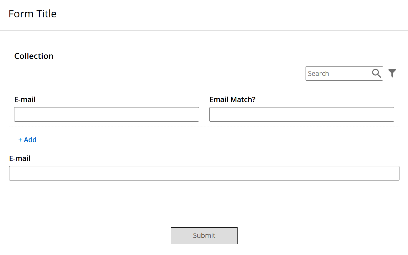

Ex. =IF(INDEX(Collection.E_mail,ROW())=E_mail,"MATCH","NO MATCH")
On my test form I have:
Add the calculation to the email address in the collection and update the variable names.
Good Luck!

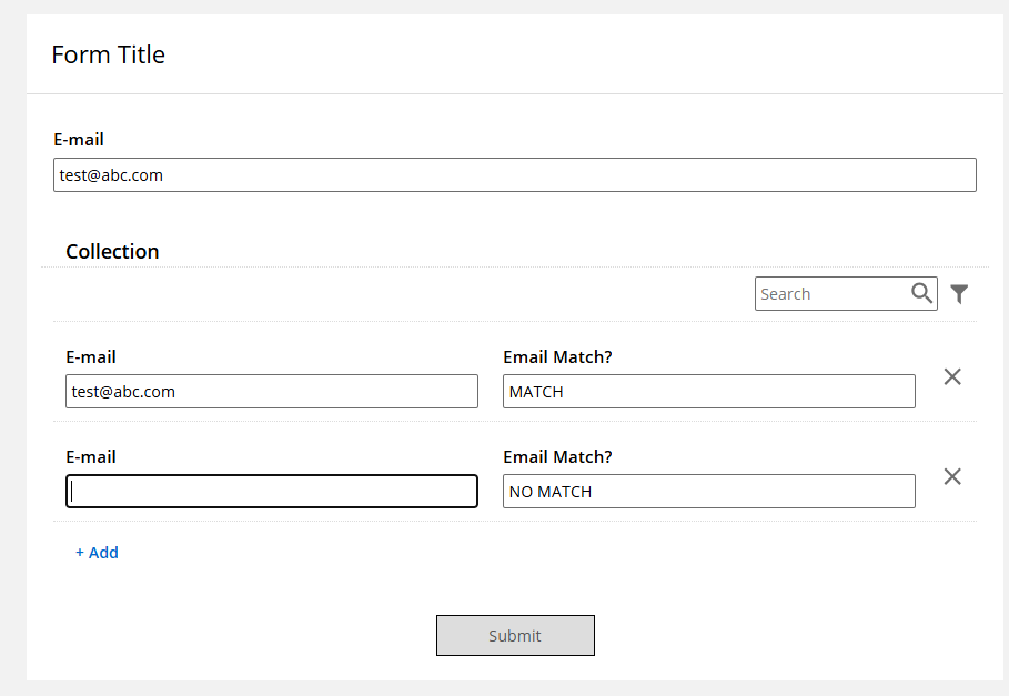

replied on December 5, 2024
Thanks. In my case, they enter the collection emails first and the email outside the collection is entered at the end.

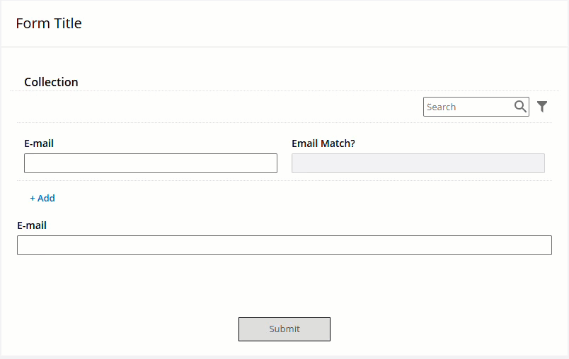

replied on December 5, 2024 • Show version history
Gotcha.
So then you could:
1. move the email outside the collection to the bottom
Like so:
2. change the calculation to:
=IF(E_mail="","",IF(INDEX(Collection.E_mail,ROW())=E_mail,"MATCH","NO MATCH"))
Looking like:
