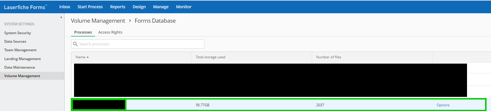

1. When I check the Administration Section of our Laserfiche Form, I can see the form is using 56.77 GB (photo attached - volumemngmnt_form.png). Is there a chance to reduce this? If so, how? And will this reduce the database file (mdf file) as well?

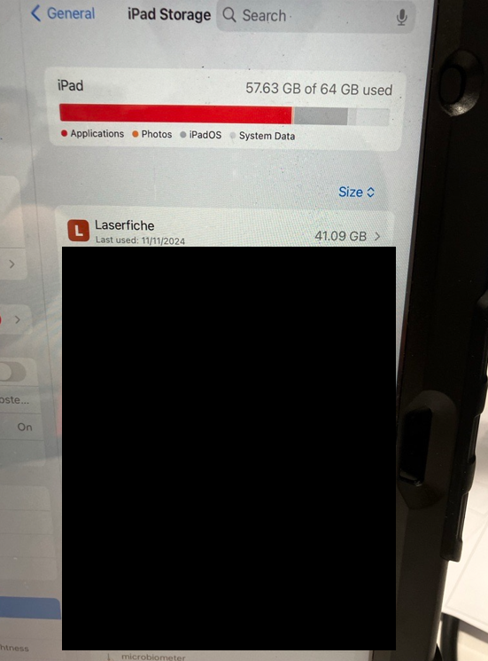

2. If I re-install the Laserfiche app on the iPad (currently it's eating 40GB of space), will I gain back 40gb of storage in the iPad? And is it correct that we won't lose any photos because they are stored somewhere in the Laserfiche server?

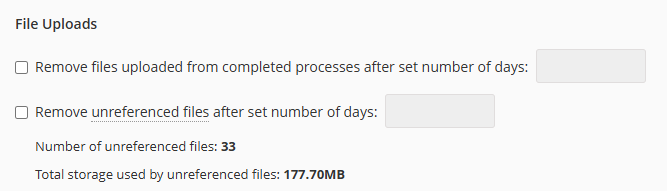

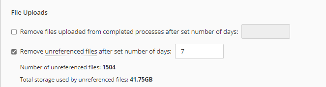

I've got the "Remove unreferenced files after set number of days" ticked as seen on the snip and the number and size of unreferenced files too. It seems like it's not working in this situation because most of the forms they've submitted are more than 7 days ago already.

1. Unreferenced files are files that are uploaded but not submitted with a form. With this option those files should be cleared 7 days after uploaded.
The clean up should start on the Clearing Time defined on this page so it is not processed immediately.
2. Yes you need to extract the image manually; you can download them from instance detail page.
And if your files are not archived yet, please do not use the "Remove files uploaded from completed processes after set number of days" option on data maintenance as it would clear the files that you may still need.

2. Also, for the iPad storage, do you have any idea how to free up the space there?
