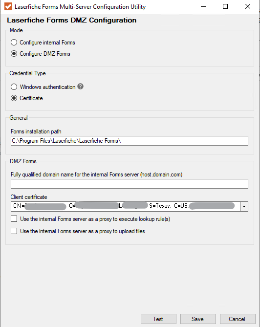

We are renewing our SSL certs for the year and after a mid-year upgrade the procedure from last year to now has changed.
Sections inside the web.config file on our DMZ Forms server no longer exist and the EndPointUtility.exe program inside the Forms/Bin folder is no longer there.
What is new is a program called FormsMultiServerConfigurationUtility.exe - unfortunatley our VAR has not seen this program before and somehow our Support Contract with Laserfiche expired...27 days before our license does.  So we have no LF mothership support, only with our VAR.
Does anyone have any experience with this program in setting a 2025-expiration SSL cert for a DMZ / Internal forms environment?
It looks straight forward, but 2 years ago our SSL renewal went sideways and we were down for a full business week.
My intial thoughts are select the new 2024-2025 SSL cert, fill in the FQDN of our internal forms server and if possible select the first option for proxy lookup (we can't create lookup rules if using DMZ server currently)
Thank you in advance.
Utility screenshots:

The FormsMultiServerConfigurationUtility.exe certificate configuration is about configuring WCF Transport Security with Certificate Authentication between the Forms IIS application(s) and the Forms Routing Service.
I strongly suspect you did not have this previously configured as it's a relatively new config option. You would thus not be at risk of issues from certificate expiration for that communication path, on account of WCF transport security with cert auth not being enabled. You would know if you had this set up - before the FormsMultiServerConfigurationUtility existed to semi-automate its setup, the only way was to painstakingly modify the configuration files by hand following a procedure that is not publicly documented.
To be explicit: Running the FormsMultiServerConfigurationUtility ("Save") will break your current configuration if you set the TransportSecurityMode to "None" per the general instructions in the Forms DMZ setup whitepaper. In order to promote more secure defaults, the FormsMultiServerConfigurationUtility does not have an option for TransportSecurityMode = "None" between the DMZ Forms IIS instance and the internal Forms Routing Service.
If the DMZ Forms server is domain joined to the same (or a trusted) Active Directory domain as the internal Primary Forms Server, you can run the FormsMultiServerConfigurationUtility on both servers and select the "Windows Authentication" credential type to easily secure (authenticate and encrypt) traffic between those servers without needing to deal with certificates yourself (they're still involved but automatically managed by AD).

Not sure if this provides any further insight.  All my "tests" using the FormsMultiServerConfigurationUtility.exe have failed.  Both with certs and with windows authentication - however we use wildcard certs and from what I understand, there may be an issues with that and this utility.
