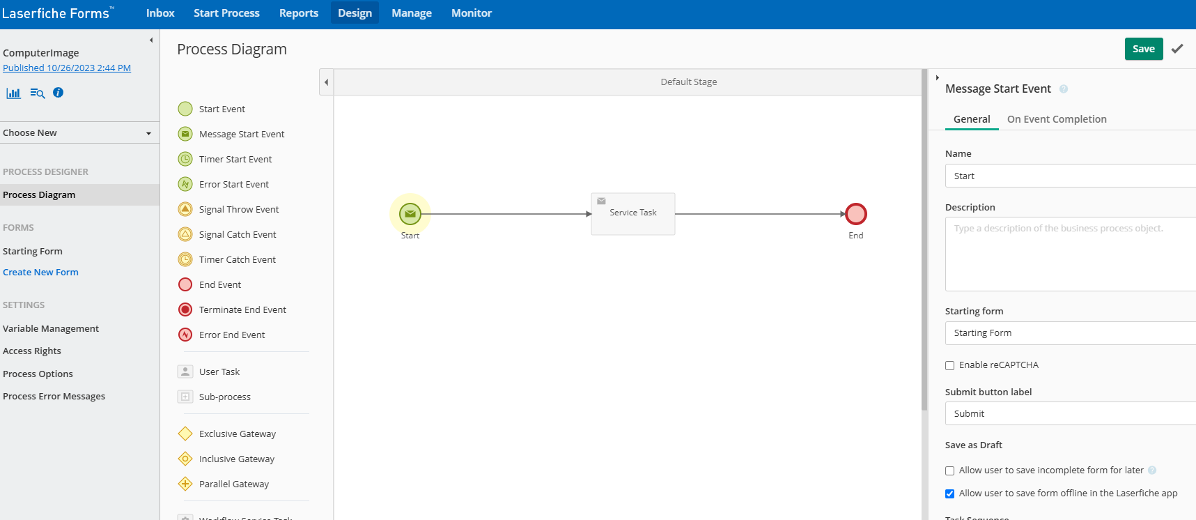

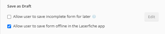

Did you verify on forms server in the design of your form that you enabled offline viewing?
Open the Form in Design view in the Message  Start Event. Half way down the properties you will see a box that you need to check so form can be viewed offline.
In order to view the form offline you must first connect to the form while you are online so it can make offline copy to your device.

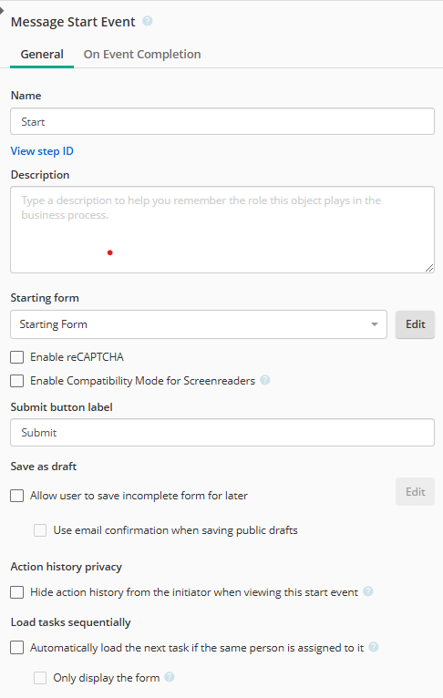

replied on December 3, 2024 • Show version history
Hi Ivan
Yes we realise that is in the form builder and that is exactly where we looked.  The option of Offline is not popping up on our end...  perhaps there is another piece of config that we are missing on?
Alex
Offline forms are not supported in Laserfiche Cloud at this time.
