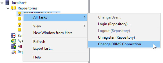

When you say you don't have access to the Admin Console, do you mean that you are unable to log into the repository due to this issue? If you at least can bring up the Admin Console and see the repository, just not access it due to the DB issue, you may have luck right-clicking on the repository name and going into the option to change the DBMS connection. This should show you what it's using currently and give you the ability to fix it up.

The user that the LF Server users to connect to the DB would not be stored in the DB since it is needed before the connection to the DB is made.  The only place I know of to find this information is in the LF Admin Console.
You must log into the repository through the admin console (as an administrative user) and then look in the repository settings properties.
