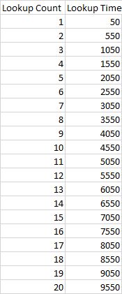

  • The first lookup averages ~50ms
  • Each subsequent lookup starts after the previous one completes and takes ~500ms.
  • As a result lookup 1 takes ~50ms, lookup 3 takes ~1050ms, lookup 10 takes ~4550ms (I've attached a table out to 20 lookups).

Approximate expected lookup load times:

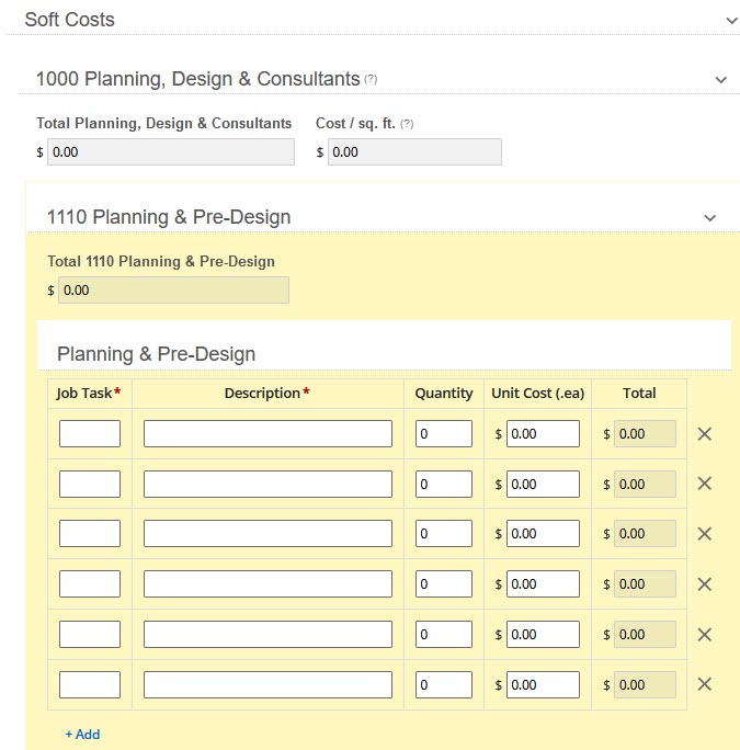

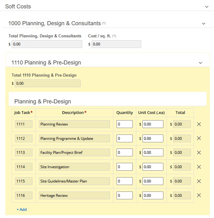

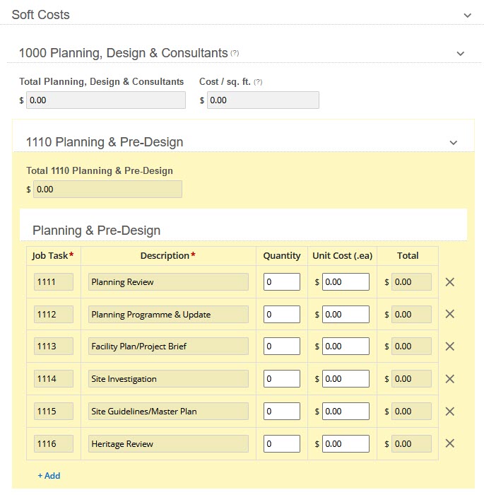

(I've attached some screenshots of what those tables look like, both before and after the lookup. The number of rows returned varies, from just a few to about 30 or so. There are about 16 tables on the form page.)
I did experiment a bit with a stored procedure but didn't notice any change in response time.
Having said that, I didn't replace each lookup with a stored procedure, for example, or mix the lookups with stored procedures, that sort of thing. So perhaps my test was too limited in scope there.
