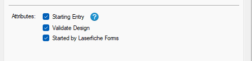

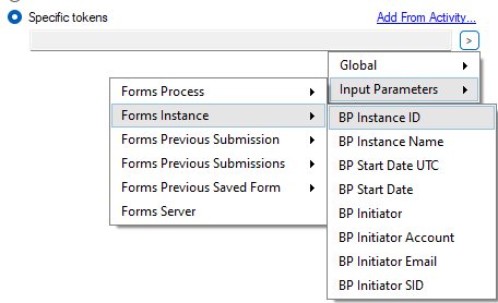

You don't have to use get business process variables activity in Workflow. You just need to check the Started by Laserfiche Forms option for the workflow,
and then you can use Forms tokens in it.
Here's the full list of Forms tokens supported by Workflow: Forms Tokens
