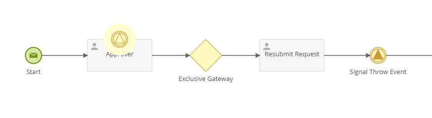

I'm trying to optimise a resubmission process, I've just been doing it through a workflow however, just wondering why this won't work.
The logic is when it hits the Signal Throw Event it sends a Signal back to the Catch Event which is tied to the approver task.
However when it hits the signal throw it just ends. Is the Signal Catch/Throw more for Parallel flows?
Thanks

Only active signal catch event can receive the signal.
With your flow, when the signal throw event is reached, the user task should already be completed.
The signal catch event would be completed when the user task it attached to is completed.
If you add a parallel gateway after the start event, and add a signal catch event on the other path, then it could keep active and receive the signal.

It would be a lot simpler if you just used an exclusive gateway to loop back to the Approver task if resubmit was the action. I don't understand the need for a signal in this process.

Yes I have been using a loop I was just looking for a new way as sometimes the diagram can get quite messy and I was trying to have a singular loopback point.
