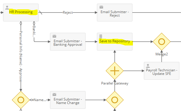

I have a Laserfiche Forms process where HR sets the path and filename that they want to use for the Save to Repository Service task.  I've had a couple of occasions where they've entered an invalid path by accident.  This causes the process to suspend when attempting to save the document.  If I use the Edit variable functionality to correct the path, it doesn't fix the save to repository task.  It's like the task won't use the updated variables.

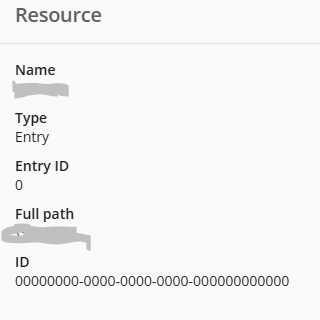

In the audit reporting it's attempting to create a folder at the root of the repository without the correct info.

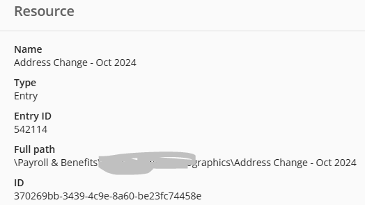

A sample of a successful submission should look like this:
