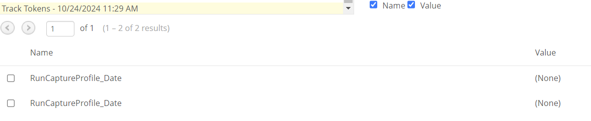

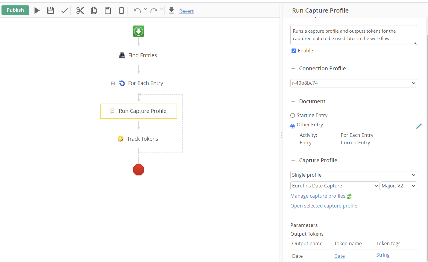

Hello I created a capture profile to look for a date in a document. I now am trying to create a workflow to pull that date however when i test out the workflow to see if I can pull the tokens they are showing no values. I know the capture profile works as I've tested it with a few documents. I created a simple workflow to test this out and it should in theory pull the date text so that I can see i tin the tokens tab.
replied on October 24, 2024
Do the documents you're running through the workflow have Laserfiche pages created? That hung me up for a while when I was starting out.

Yes there were laserfiche pages created when they were imported. I re-generated the pages and I was able to get the workflow to work. Thanks for your help.
