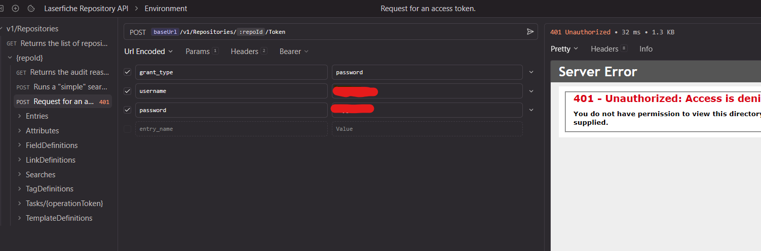

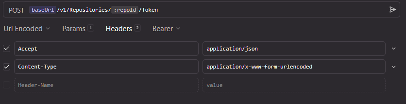

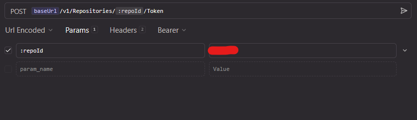

When accessing my locally  installed swagger environment from the browser, I'm able to get connected, authorized, and generate a token without any issues.  When I try to connect to the API using Postman or YAAK, I get a 401 'Unauthorized' error.  As far as I can tell, I've set all my headers and encoding correctly.  What am I missing?

It would be helpful if you could share a screenshot of Postman or YAAK setup. Please make sure to redact any sensitive credentials or URLs as this is a public forum. I know people here have connected to the API with Postman before so that would allow comparison.

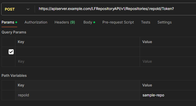

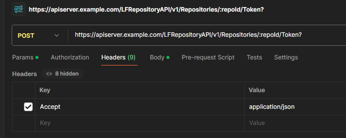

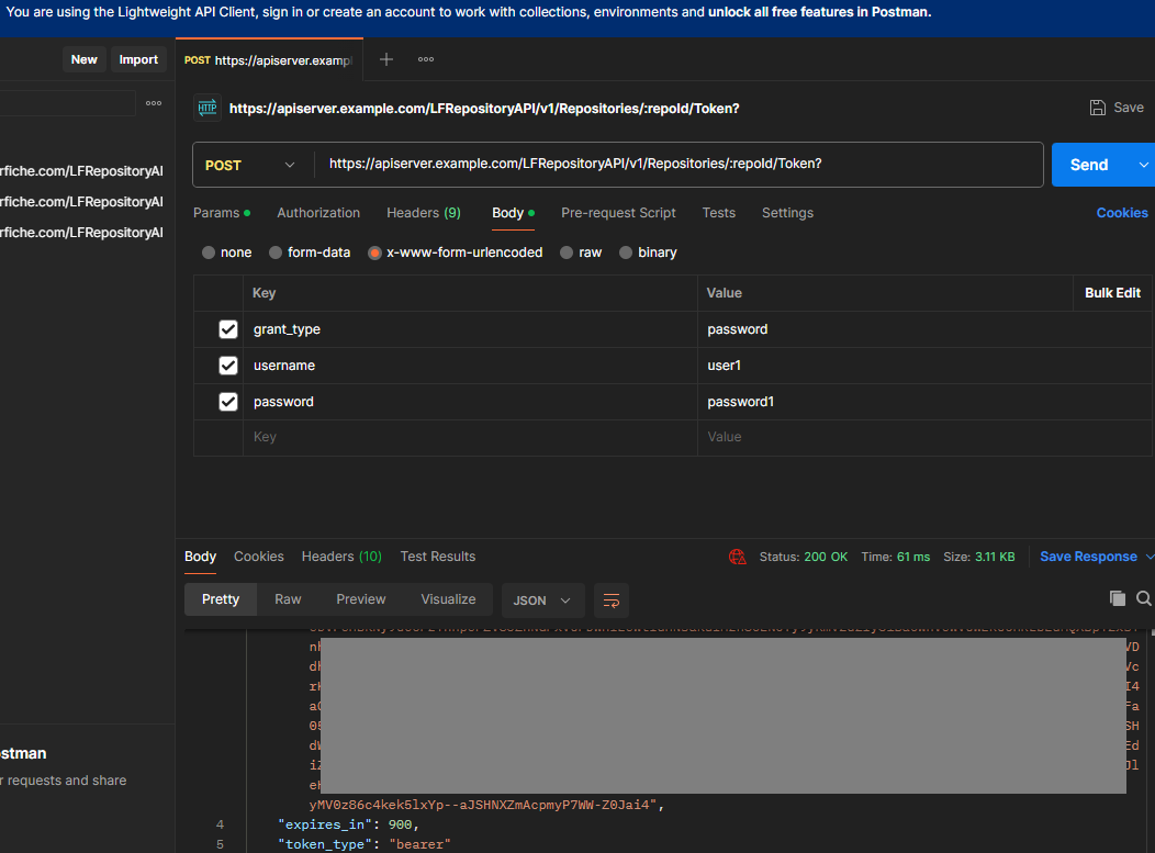

replied on October 23, 2024 Show version history
I verified that Postman works:
