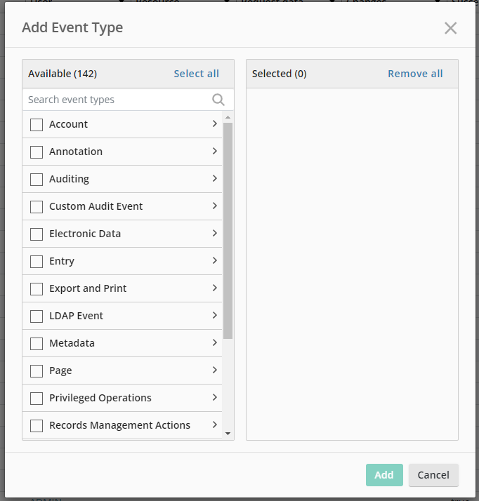

Is this the menu to select the Forms events I want to pull for a report in Audit Trail?
Or does Audit Trail not have the ability to display Forms events in a report?
replied on October 18, 2024
No, that is for the repository. I recommend reading through the help file link that I sent you and the corresponding Forms Audit Trail pages to get an understanding of how it works for Forms.

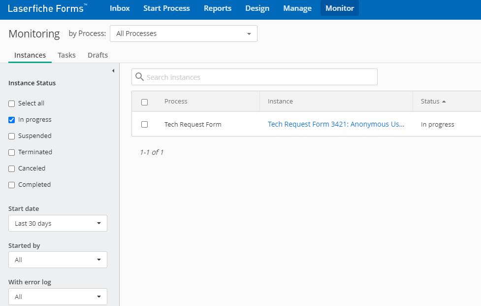

Hi Jacob,
Is this what you are looking for?
Forms Administration in the Monitor Tab I can filter by forms still in progress
