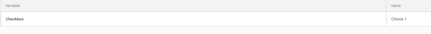

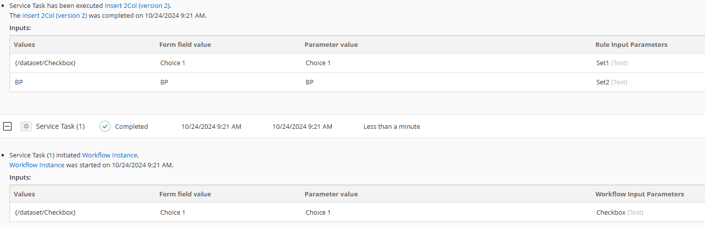

Is this still an issue for you? We just made some changes to checkbox label vs value in business processes. I also wanted to confirm that you are using a checkbox and not another field type like radio button for example.
What I'm seeing:
1. Both Forms Rules and WF Rules are using non-spaced (label) for insert
2. The variables tab is also showing non-spaced (label) for the field value
