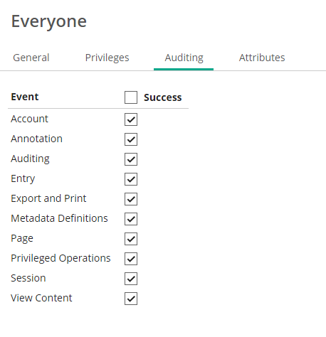

We had a customer that needed to make use of the audit trail in Cloud but found no events, then we found it was not enabled after checking the configure audit trail documentation.
They don't think it is very likely that someone with administrative access would have found and disabled it on purpose or by accident.
All the boxes below were unchecked on the Everyone user. Is this something need to be manually enabled for cloud systems. Often people don't know they need audit trail until something unexpected happens.

I can only speak from my experience with our client cloud environments and the Everyone user definitely has Auditing enabled by default for all event types with the exception of Search and View Entry.  Those two event types are not enabled by default as they generate a lot of audit log data very quickly for a relatively low risk event.

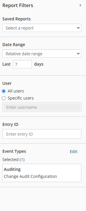

The good news for your particular issue is that even if it seems unlikely that an admin user would have made a change to the Everyone user, if they had it would have been recorded in Audit Trail.
In Audit Trail if you set the Event Types to include Auditing > Change Audit Configuration for your Report Filter it will show any time the Audit Configuration has been altered.

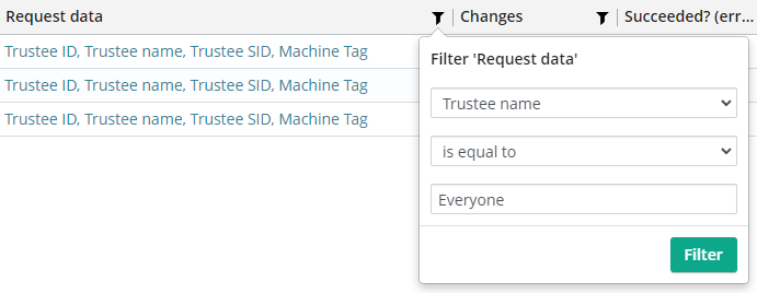

You can additionally set a column filter on the 'Request data' column to limit the returned events to only include items where Trustee name is equal to Everyone.

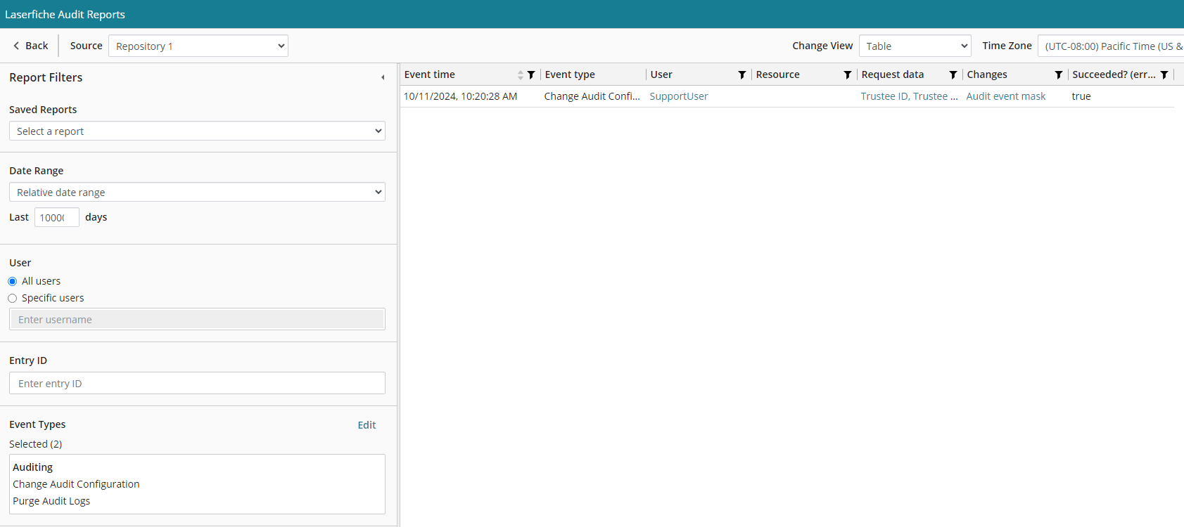

replied on October 11, 2024 Show version history
Thanks for that insight. It seems maybe someone purged the audit logs here? And it purged even the purge event history? I just searched back 100,000 days and all I get back is the change made today to enable auditing. How can this be possible, how is there not even a login event or any other events in all of history until today when we enabled it.
