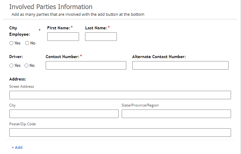

A Picture of the Collection for reference.

Where is your calculation field? In your screenshot I can see your source fields in the collection, but it's not clear where the calculation is happening.
As a note, the ROW() function works in the context of a field's parent table/collection, so your calculation should work if it inside the same collection, but if it is a non-repeatable field outside of the collection there is no "row" value to reference.

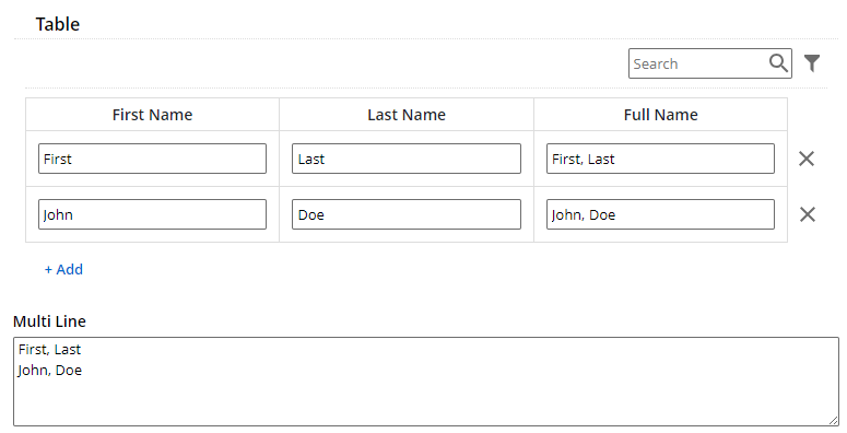

My suggestion would be to do the calculation inside the table with a hidden column; this way you have a preformatted list to work with rather than trying to match up two columns from outside the table.
Add a (hidden) column inside the table, and the calculation you already have will work to produce a "First, Last" name for each.
Then, you can use the JOIN function/calculation in your multi-line to display that list with whatever delimiter you choose.
For example, the following would show all values of the column separated by a line break character, which can be added with CHAR(10).
=JOIN(CHAR(10), Collection.Full_Name)
The end result should be something like this
