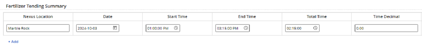

I have a form with a table like below:
There are fields above this that are used in a stored procedure to return new rows to this table. The Time Decimal column uses the below formula to turn the Total Time column into a decimal that gets used to bill based on hours.
=PRODUCT(TIMEVALUE(INDEX(Fertilizer_Tending_Summary.Total_Time, ROW())), 24)
The stored procedure will populate the Total Time column, but unless I change the value that gets populated, the Time Decimal field calculation does not happen - it remains at 0. Is there anything I can do to get that calculation to fire when the lookup happens?

I don't believe you can trigger the calculation after the lookup is complete on an append table (maybe with JS) but you could do the calculation in a sql view from your table with the following:
ROUND(DATEPART(HOUR, totaltime) + DATEPART(MINUTE, totaltime) / 60.0, 2) AS Time_Decimal
Populate the field from your lookup and use a number field instead of a single line field and make the decimal place to 2.
