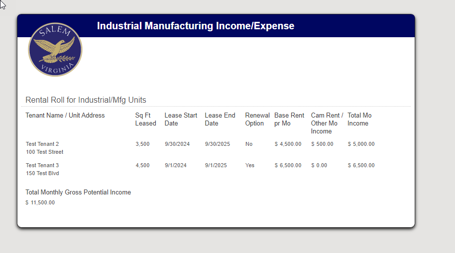

This is the form that produced the error:

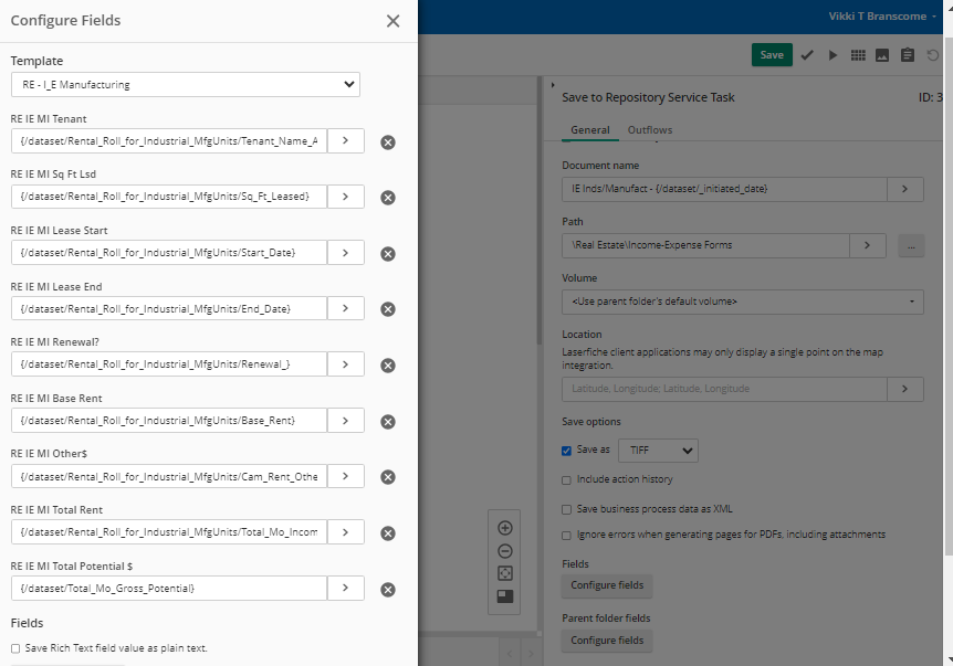

This is the Forms mapping config:

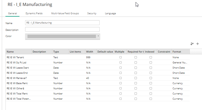

This is the field group in the template:

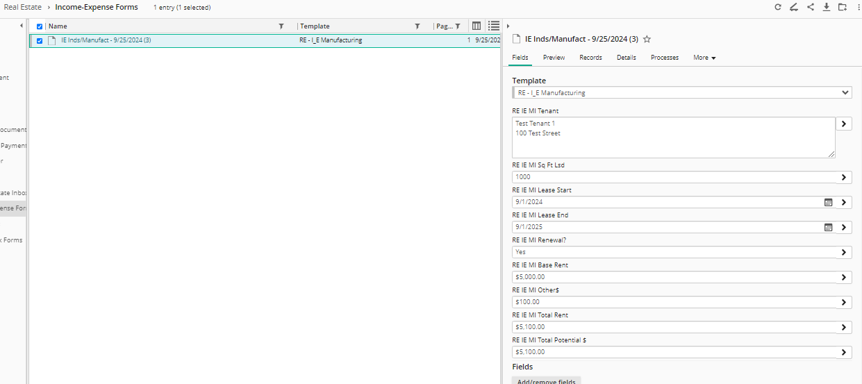

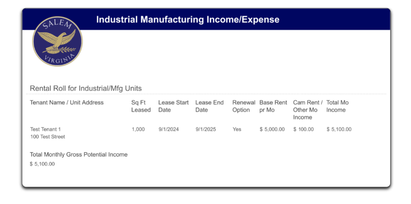

This is one that worked correctly, but only had one row of data in the table:

I'm not sure if its this simple, but I think you may need "multiple" checked in the templates because you are passing a table with multiple rows to a single template field.
