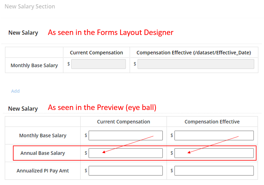

I need a way to do a very simple calculation on one of the rows in my table. The forms user will input the monthly base salary in both columns (current and effective), they will also input manually the PI Pay amounts. I was trying to allow the forms user to skip the annual base salary row because it is simply whatever was input on the monthly row above times twelve (*12).
The name of the table is:
Salary_Schedules
Column 1 are the row titles
  • Monthly Base Salary
  • Annual Base Salary (the row I need to calculate *12 from "Monthly Base Salary")
  • Annualized PI Pay Amt
Column 2  Current_Salary_Schedule_Monthly "Current Compensation"
Column 3 New_Salary_Schedule_Monthly "Compensation Effective"
When I view the variables of this table in variable management, the only thing I can see is the column headers as variables, not what each "cell" variable name or field ID would be.
Would this need to be handled via Java script or CSS?
My only other option is to bail on the look of the table all together and use single line fields and currency fields independently, which is fine, but was hoping to keep the clean look of the table if possible.

Your best option here would be to use JavaScript because any formula you put into the table that needs a previous rows value would be a circular reference. You could use the following function to do your math, just update the first variable to the field Id of the comp fields
const currentCompFieldId = 58;
const compEffectiveFieldId = 59;
LFForm.onFieldBlur(
  async (e) => {
    const rowNum = e.options[0].index;
    if (rowNum !== 0) return;
    const [monthlyComp, annualComp, piComp] = LFForm.getFieldValues({
      fieldId: currentCompFieldId,
    await LFForm.setFieldValues(
      { fieldId: currentCompFieldId, index: 1 },
      12 * monthlyComp,
  { fieldId: currentCompFieldId },
LFForm.onFieldBlur(
  async (e) => {
      fieldId: compEffectiveFieldId,
      { fieldId: compEffectiveFieldId, index: 1 },
      12 * monthlyComp,
  { fieldId: compEffectiveFieldId },
