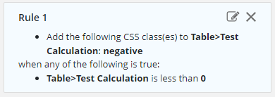

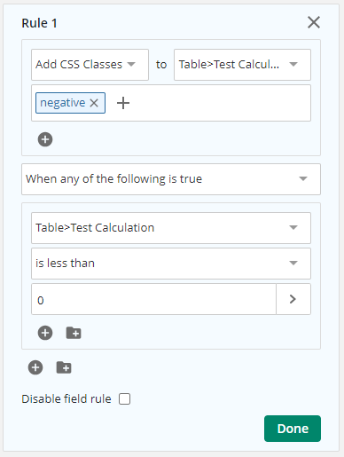

You can achieve this with a mixture of field rules & CSS in the modern designer by doing the following:
On your Total/calculation field, assign a field rule to add a CSS class when the value is less than 0. I named my CSS class "negative".
Next, add the following CSS (adjusting the class name and the colour if necessary):
.negative {
  background-color: #FF786E;
  color: initial !important;
Let me know if you have any questions and I can try and help troubleshoot if needed. :)

replied on September 25, 2024
If you're just worried about CSS styling, that should be easy enough to rework in the modern designer, and then you get the added benefit of all the new features. However, if you're using any Javascript, the classic designer has more capabilities.
This coding & rule will highlight each negative value cell within the Total column. (Not the whole column, and not the whole row.) Does that work for you?
Thank you so much, your solution worked for me and also forced me to learn a little more about the Modern Designer... something I have not taken too much time to learn.
