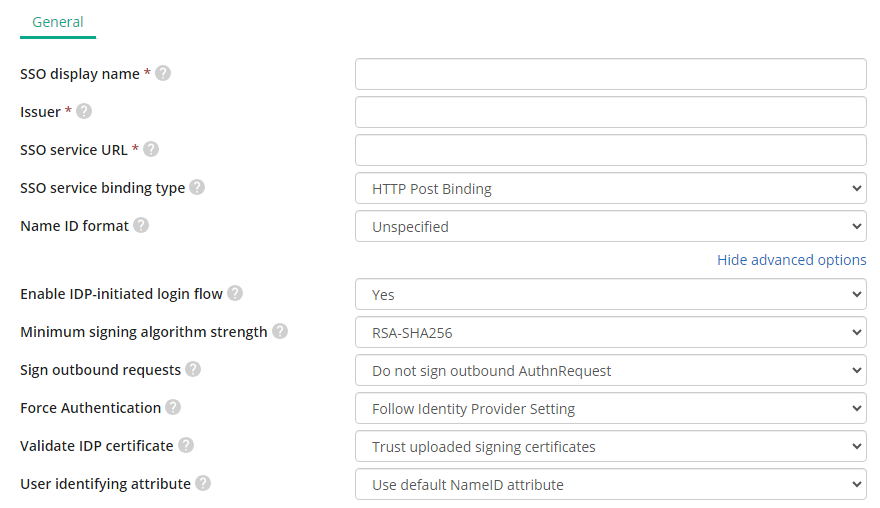

While trying to setup SSO with LF Cloud and Google (which only supports IdP-initiatated authentication) there is a required field in the SSO config page for a SSO Service URL which is not something we can provide if using IdP-initiated authentication.

First, make sure you have it enabled on the Laserfiche Cloud side.
See: Configure Advanced SSO options in Laserfiche Cloud
  • Enable IDP-initiated login flow: Specify Yes for this feature to allow a user to sign in to Laserfiche from the identity provider's portal.

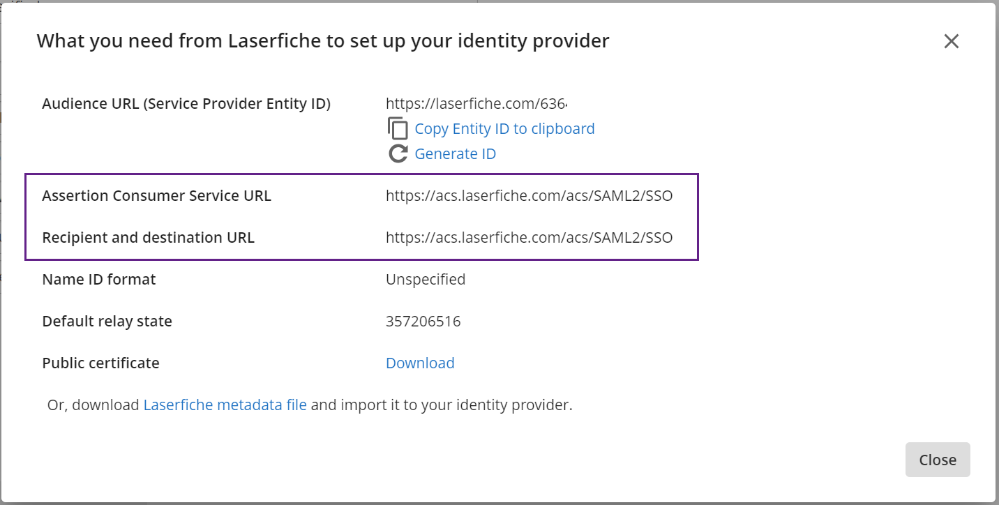

The "SSO Service URL" Google is asking for is the "Assertion Consumer Service URL" that Laserfiche Cloud gives you from Account Administration > Settings > Single Sign-On > Service Provider Information:
Laserfiche Cloud uses the same Assertion Consumer Service URL for both SP and IDP-initiated login flows: https://acs.laserfiche.com/acs/SAML2/SSO (or non-US regional equivalent).
We have IDP-initiated SSO configured for some of our internal Laserfiche Cloud accounts, and I verified that the IDP-initiated SAML Response is going to https://acs.laserfiche.com/acs/SAML2/SSO.

Google isn't the one asking us for the SSO service URL, Laserfiche is the one asking for it; on the SSO config page. I checked under advanced and it says Enable IDP-initiated login flow = Yes but IdP-initiated Identity Providers do not provide this service URL.
Google expects that the IdP will handle initiating the authentication request (IdP-initiated flow), so Google doesn't need an SSO Service URL to handle login requests from its side.
Instead, Google focuses on the Assertion Consumer Service (ACS) URL, which is the endpoint where the IdP sends the SAML response after a user is authenticated.

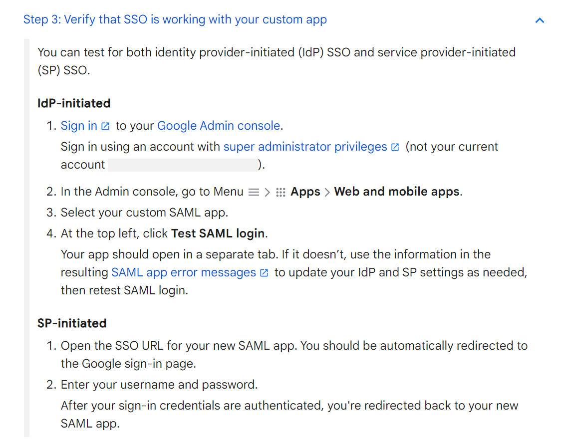

Google's Set up your own custom SAML app Using SAML-based SSO says plainly that it provides an IDP SSO URL:
  1. (5.) On the Google Identity Provider details page, get the setup information needed by the service provider using one of these options:
    1. (a.) Download the IDP metadata.
    2. (b.) Copy the SSO URL and Entity ID and download the Certificate (or SHA-256 fingerprint, if needed).
And I assure you that Google does not only support IDP-initiated SAML SSO flows. They literally provide instructions on testing both IDP and SP-initiated flows on their SAML config page (see below), and I've worked with customers to set up Google SAML SSO with both SP and IDP-initiated flows enabled with Directory Server. It may be that your customer has somehow disabled SP-initiated SSO at an administrative level in Google Workspace, but it is certainly supported.

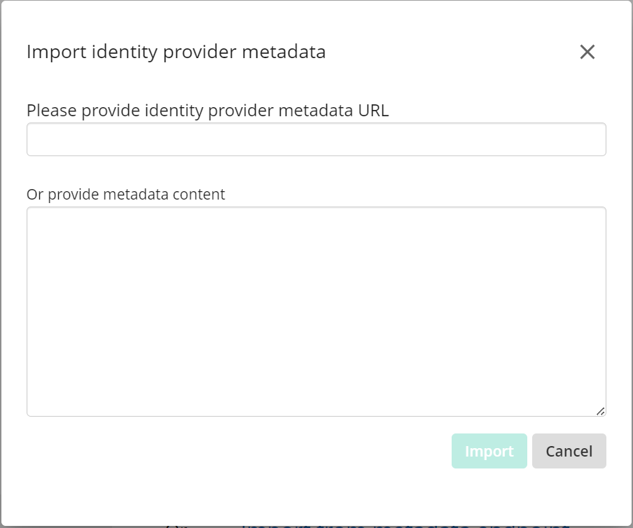

If you can't find the IDP SSO URL value in the Google UI, try downloading the IDP metadata and pasting its contents into the Laserfiche Cloud "Import Metadata" dialog, Import, and see if the value populates:
