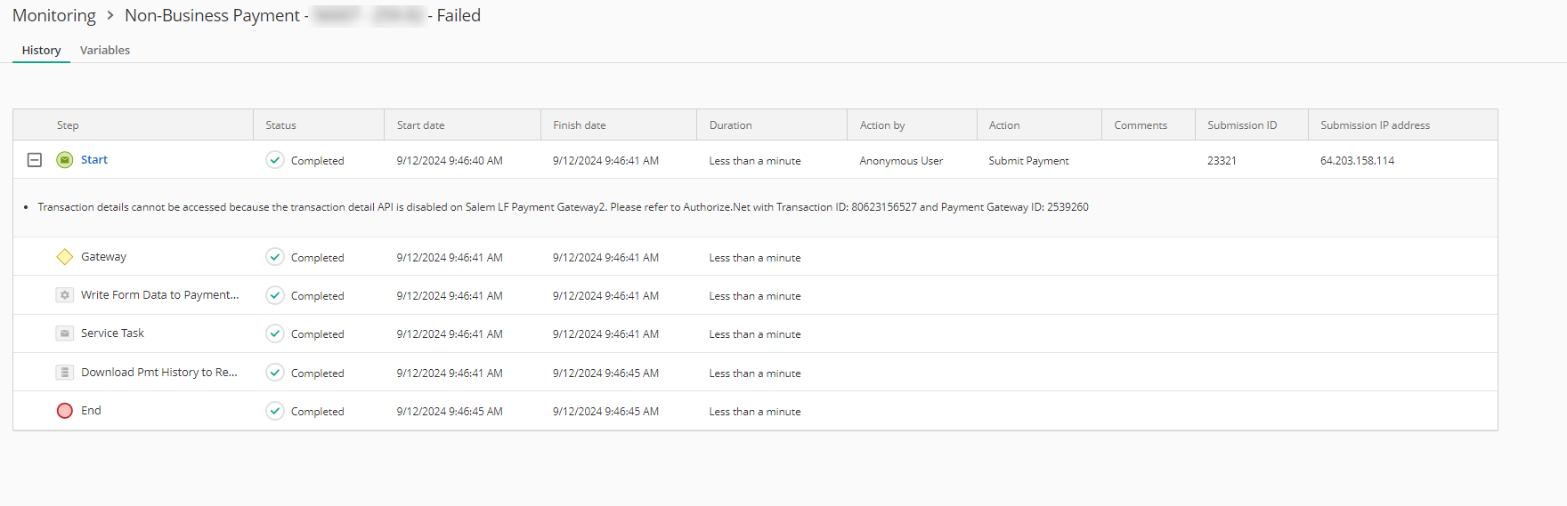

In the forms instance monitor screen, the following message appears in the instance history; Transaction details cannot be accessed because the transaction detail API is disabled on Salem LF Payment Gateway2. [See screenshot below] We did not ever disable this, it is not currently disabled, and transactions since this one have gone through without issue. I sent an email to Authorize.Net and their answer to me is that we need to generate a new Transaction Key in Authorize.Net and update it in our LF server. We researched this and found that best practice is to generate fresh codes every year, similar concept to updating passwords. We intend to do this and make it a regular practice. This does not answer the question though. If that were the issue, it does not explain a response that the card was declined due to an invalid card number or that other transactions since are going through.

The error in your screenshot states that since the API was disabled at that time, the transaction details could not be retrieved. If the API was down, how could you get a response that the card number is invalid? Based on the error in your process it just looks like the transaction details were not available while the API was offline, not that it did not go through. You can't disable the API, your the one calling the API, Authroize.net is the one who disabled it (likely for a maintenance window)

That does make sense as far as the error in the instance details. If they disabled it, though, we were not provided that information ahead of time or after asking about this issue.

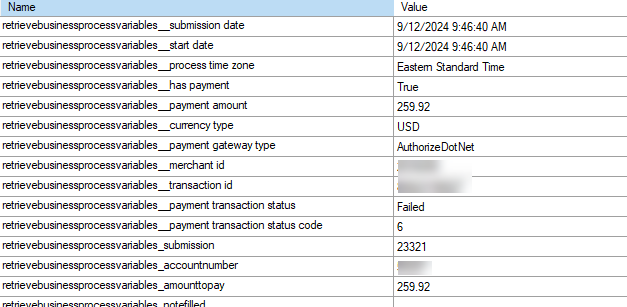

This is the exact response we received from Authorize.Net (see below). They sent back a code 6, and code 6 is Invalid Card Number. We actually can disable/enable the Transaction Details API in our settings menu. We didn't though, no one with access to this setting had logged in to our account.

I would pull up the transaction details on Authroize.net for this ID and ask them why it is showing a 6 in the transaction code. Unless your saying on their website, it does not show a 6. I doubt Laserfiche just made that number up.

I think Jason might be right, they might be flipping numbers on you, thankfully you have the track tokens to verify it returned a 6 at the time. It is really odd that you got an error about the API being offline with the same transaction, something unusual was happening at that time but your captured the code 6 response so someone must have changed it after that.
