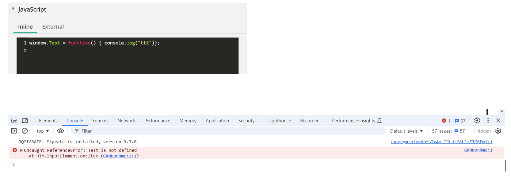

replied on September 19, 2024
Hi,
We tried this exact snippet but still we are getting an error. Have attached the screenshot.
Are you on the latest version of Forms? 11 update 5?
replied on September 20, 2024
We are on version 11, attaching the exact one below
replied on September 24, 2024
Ah, yes this feature was added in update 5 (11.0.2311.50564)
Is there any workaround for getting this to work in the current version we are in ?
replied on September 24, 2024 • Show version history
Unfortunately none that wouldn't break when you update to update 5 and beyond. There was a significant amount of enhancements done to the new designer in update 5 so I definitely recommend updating if you can.
