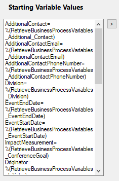

I have a process where I am trying to use one form to invoke many of another form.  On the starting form that is being invoked, there's only two fields that need to be input, but there's a significant amount of setup happening in the background based on those two fields, including setting default values, calculations, and database lookups.
When I invoke the business process, only the values that were input into the variables show up in the invoked form, none of the starting form's setup comes through. Do I have to mirror all the data setup that happens in the starting form using workflow tokens/variables?  Is there a way to invoke the form to get all the starting form set up pieces without going through duplicative effort?

You will need to setup the Starting Variable Values if you want to pass those values to the invoked form. I usually proceed the Invoke Business Process activity with a Retrieve Business Process Variables activity and grab the variables I need.
