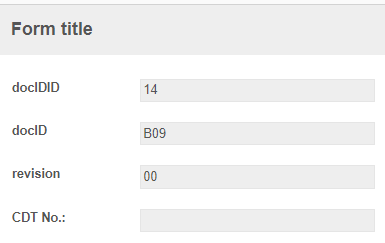

I've set up a form with defaults that are required as input for getting a document number through a stored procedure.
And I set up the lookup rules as follows:
Here's the stored procedure:

It gives me the correct number, but skips to every third number. Any ideas why this could be happening?
replied on September 13, 2024 • Show version history
So, turns out, I cannot set the defaults ahead of time in the form. I set the defaults through javascript instead, and it works!
$('.docIDID input').val('14') && $('.docID input').val('B09') && $('.revision input').val('00').change();

replied on September 10, 2024 • Show version history
Here I am reading the stored proc when the solution is more obvious. I think what is happening is you're getting the third invocation of this stored procedure. Note you have 3 input fields in this lookup rule. Laserfiche doesn't know when you want to invoke the rule so it does it each time one of those fields change. The defaults are set sequentially even if they look like they are set at the same time.
You could either:
  1. Use the autofill button and use that to start the stored procedure
  2. check in the stored procedure that you have valid inputs before inserting into the table
