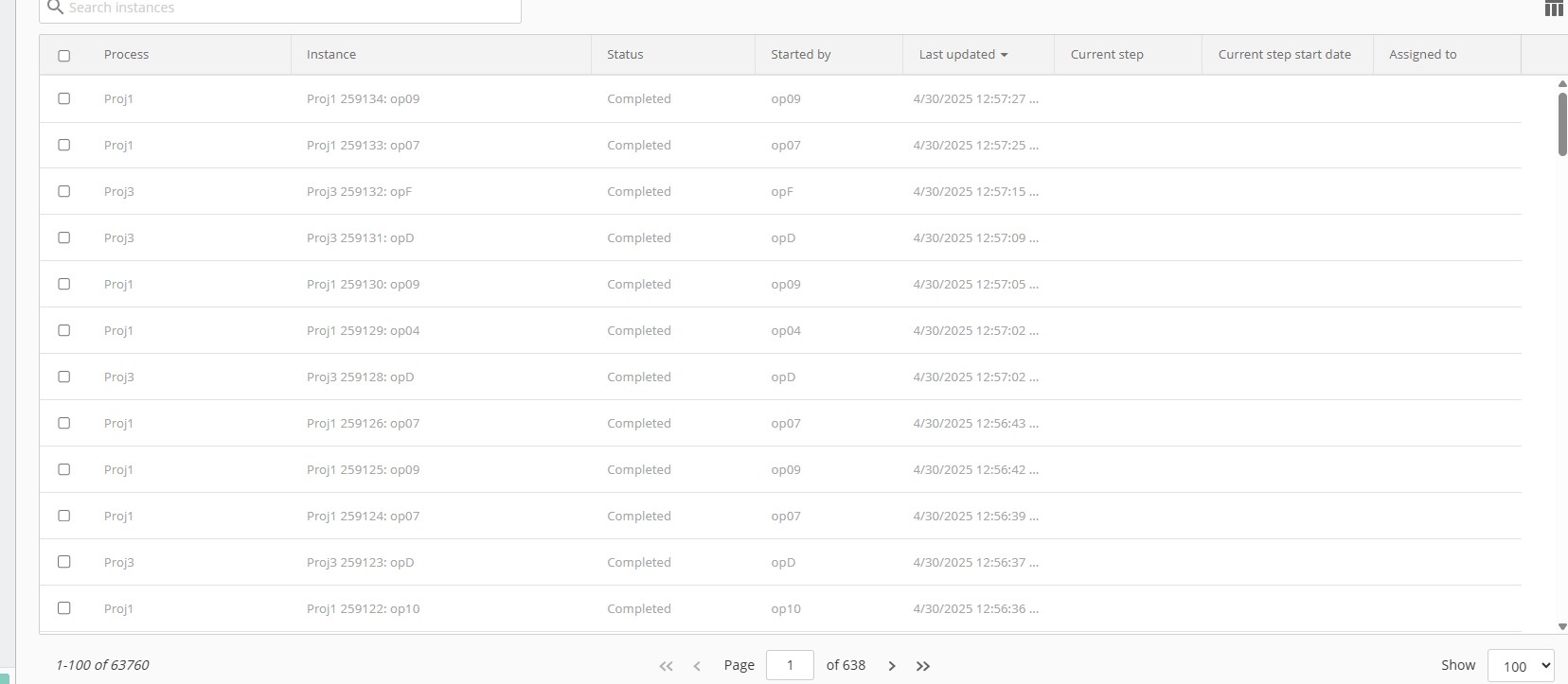

Hello I am also facing similar issue.
The grayed out instances are not deleted and they stays there which is reserving storage in the database. Have you been able to fix this issue ?

We are seeing a similar issue where the maintenance plan is not removing the data or statistics and appears to be causing issues while running.  I am opening up a ticket with Laserfiche but am hoping someone might be able to shed some light on this.
replied on September 24
I think I just needed to check this box, which they left unchecked. I can verify this is not a problem in the latest build
We are on Forms 12 and still seeing errors like you mention.  Ours is turned on but as the Forms environment is 10+ years old, there are over 400,000 thousand instance data/statistics it should be removing that it isn't.  I almost think the process of catching up is too large for it to handle and thus I may have to set the time much farther back so it removes them in much smaller batches.  Thanks for the quick response.
