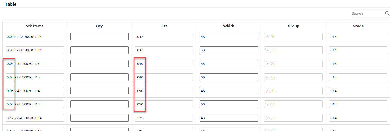

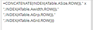

I have a table that is looking up field values from an external source table.  I've added a single line field in that table to concatenate the four field values together as a simpler "display" field.  But, I noticed that if my Size field has a value that ends in 0, it's dropped on the concatenate field.  See screen shot of my table and my concatenate formula.  Any suggestions on how I can get the ending zero to display?

You probably want the FIXED formula.
Here's Help Documentation about it: https://doc.laserfiche.com/laserfiche.documentation/11/administration/en-us/Default.htm#../Subsystems/Forms/Content/FieldCalculations.htm?Highlight=FIXED
Probably need to wrap this part:
INDEX(ATable.ASize,ROW())
Inside the FIXED formula, something like this:
FIXED(INDEX(ATable.ASize,ROW()), 3)

replied on August 27, 2024
That did it!  Thanks!
