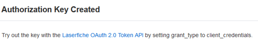

When you create the key, it says:
So you go to https://signin.laserfiche.com/oauth/swagger/index.html

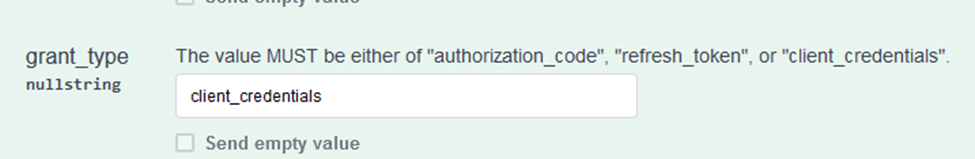

and set the grant type:
Good?

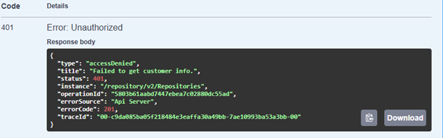

Nay, nay!

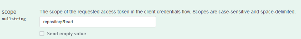

When you switch to the API and run anything, you will get "Access Denied".  You need to set the scope again:

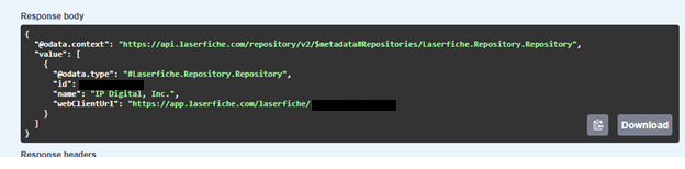

Then you can run the API, here just getting the Repo name:
Which is much better than:

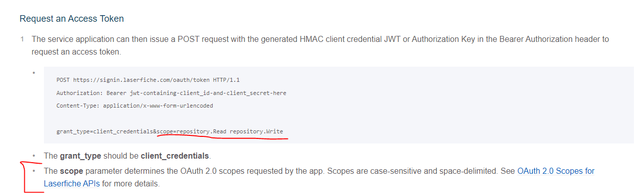

Thank you for sharing this with the community.  Our documentation does mention that you need to also send the scopes in the access token request but we will see if we can make that more clear and maybe mention that in the developer console instructions for creating an app.

replied on August 27, 2024
Thanks Andrew - indeed it does - I will edit the post.
