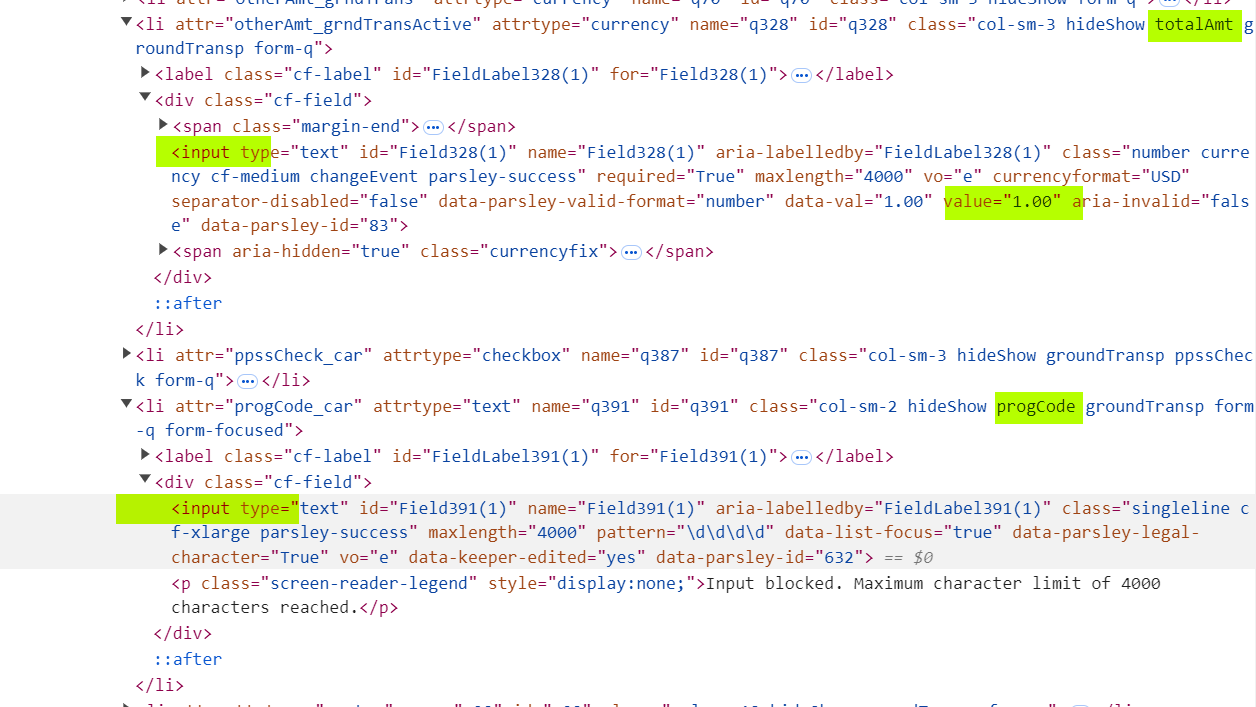

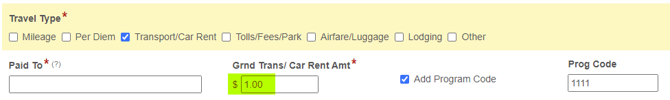

My starting element is this text field:
 $('.eachTravColl').on('change', '.progCode input', function(){
For some reason I can't seem to traverse up to the .totalAmt field:
I'm trying to get the value of .totalAmt. Easy, right? Not sure why this is not working.
Things I have tried:
    var TotalAmt1 = $(this).parents('li').prevAll('.totalAmt').find('div input').val();
    var TotalAmt_1 = $(this).parents('li').prevAll('li').filter(function(){
    	return $(this).attr('class')==='totalAmt';
    }).find('div input').val();
console.log('totalAmt val: '+TotalAmt_1);
I've tried parents(), siblings() and closest() to traverse up. I can return the correct id for the field I need but, it will not return the value for some reason.

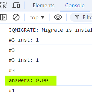

Thanks so much for your reply. I tried that actually. The problem I think is that it is in a collection with other .totalAmt fields so I need the closest (up 2 elements) one's value. I tried your code and it returned the wrong value.
      var answers = $(this).closest('li').prevAll('li.totalAmt').find('.cf-field input').val();
console.log('answers: '+answers);
it's a tricky one ha ha

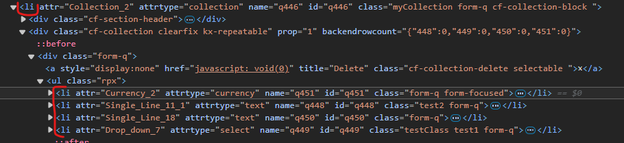

You might want to check that $(this) is returning the expected value and that all your classes are entered correctly.

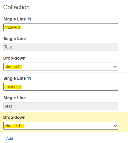

I tested the following code with a Collection and it still worked.
  $('.myCollection').on('change','.test1 select',function(){
    $(this).closest('li').prevAll('li.test2').find('input').val($(this).val());

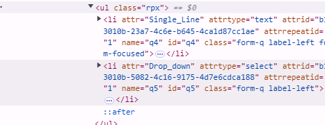

Each row/set in a collection is grouped within a parent with the rpx class so you shouldn't be running into other total amount fields with prevAll.
In the following screenshot, the code is applying the dropdown selection value to the associated Single line. I put it before the source field and added another field as a spacer so it would be the same basic setup as yours.

I still think there's some other factor at play here because the example I sent works when I test it, and the DOM structure is the same.
Also, you're already navigating up to retrieve the rpx parent for the following:
var travRow1 = $(this).parents('.rpx').find('.inst input').val();
So you might be better off just grabbing the parent once, assigning it to a variable, then referencing that to get both of the values.
let set = $(this).closest('.rpx');
let totalAmt = set.find('.totalAmt input').val();
let travRow1 = set.find('.inst input').val();
Also, be careful using .parents() since that keeps going up to the root of the DOM and can return more than you expect.
For example, if you use .parents() in the following example, it would return both the parent li AND the li parent of the collection. Even if the first result is the right one and it doesn't "break" anything, it is still doing unnecessary work.

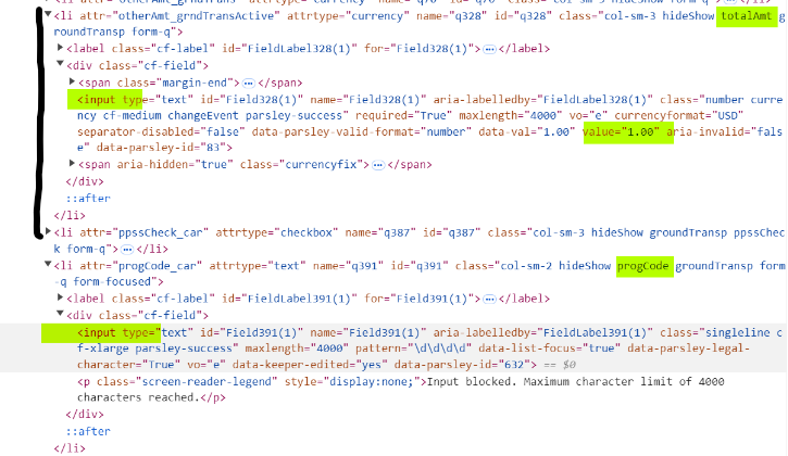

By going up to the parent 'li' your only going this far before you try searching children again for the totalAmt which is in an adjacent 'li'
So try going higher, to the parent of all the fields in the set, which is a 'ul'
From there you can use .find because your other fields within the set will all be child objects

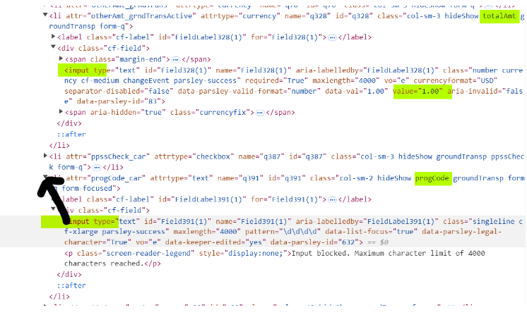

I think there's something else going on that we haven't quite figured out yet since it seems to work as expected when I tested with a collection.
.prevAll() looks for sibling elements, so navigating up to the parent li should still get you where you need to go even with a collection.
.closest() instead of .parents() would ensure it stops at that first li since .parents() grabs matching ancestors all the way up to the root.

yes, multiple totalAmt in the collection set, so I need the closest one, which in this case is up 2 li elements.
It is not up 2 li elements, it is adjacent to the li element your going up to. The method find() goes down the layer to descendants, not over.
All these li objects are on the same margin
So go up to the ul element and now your in the right spot to stay within your collection set.
Now from here you have multiple fields with the same class name, so get them all and "for each" through them finding the one you want to work with by whatever makes it distinct, it's label, a second class name, it's index. Whatever differentiates it that makes it the one you want to work with.
