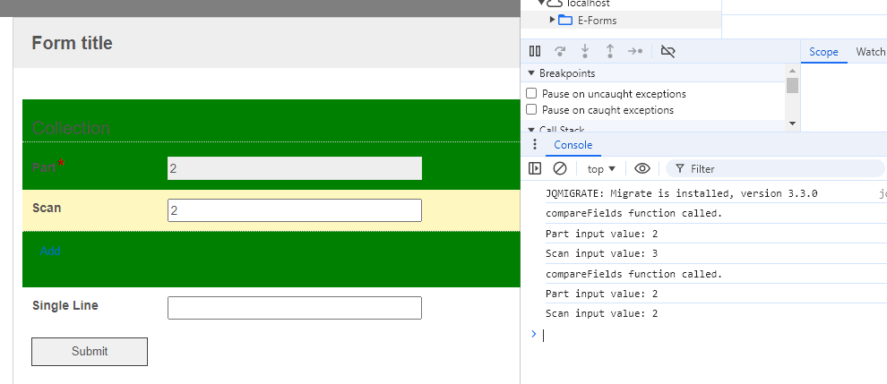

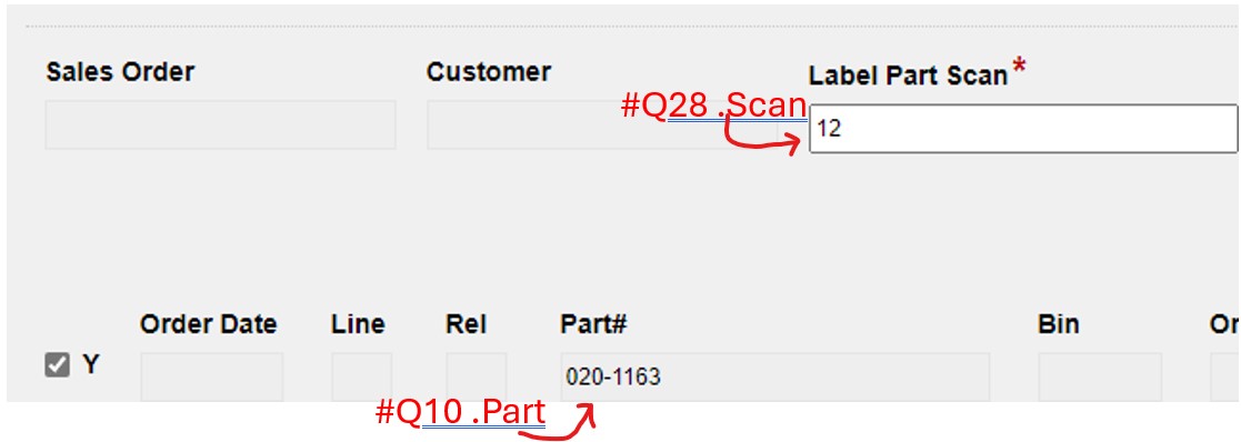

Here is a visual of the form.
replied on August 16, 2024
Try on 'change' instead of 'input' maybe?
Are they both single line fields, or is Label Part Scan a number field? Comparing a number to a string can cause issues.
replied on August 18, 2024
Your latest code works perfectly in my test without any modification, as Genny suggested, are you sure you are comparing two single line fields? And are these fields inside a same collection? Or are you referring to correct class name?
Thank you Jennifer.  Unfortunately, my script isn't working even just to the point of getting the data, never mind what to do with it after.  Change color of rows vs set a value to another field.
