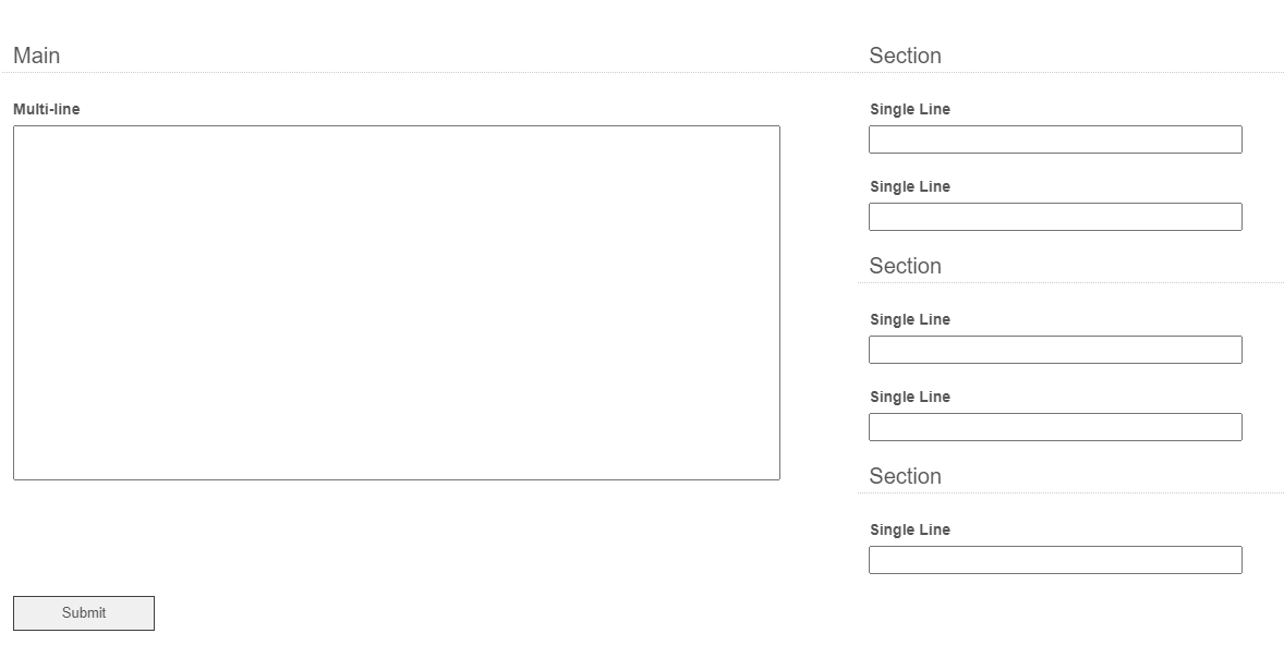

replied on August 20, 2024
How big is your multiline field? is it big enough that the section containing it is at least as tall as the three sections to be put on the right? If thats the case you can add the class col-sm-8 to the main section and col-sm-4 to the sidebar sections and you should get something that looks like this:
These col-X-Y classes are bootstrap classes so if for whatever reason this form is loaded on a small screen it will default to the regular form behavior with fields on top of each other. https://getbootstrap.com/docs/3.4/css/#grid
replied on August 21, 2024
Thank you so much Zachary

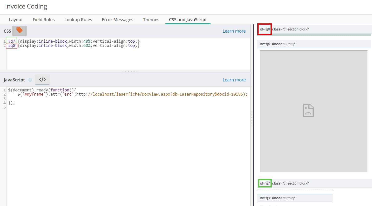

replied on August 14, 2024
David,
In Short yes.
I do this to get an iFrame next to fields like below:
Use the following CSS:
#q7 {display:inline-block;width:40%;vertical-align:top;}
#q8 {display:inline-block;width:60%;vertical-align:top;}
just make sure to update the q#'s to match the numbers of your sections.
I hope that helps.
Good luck!

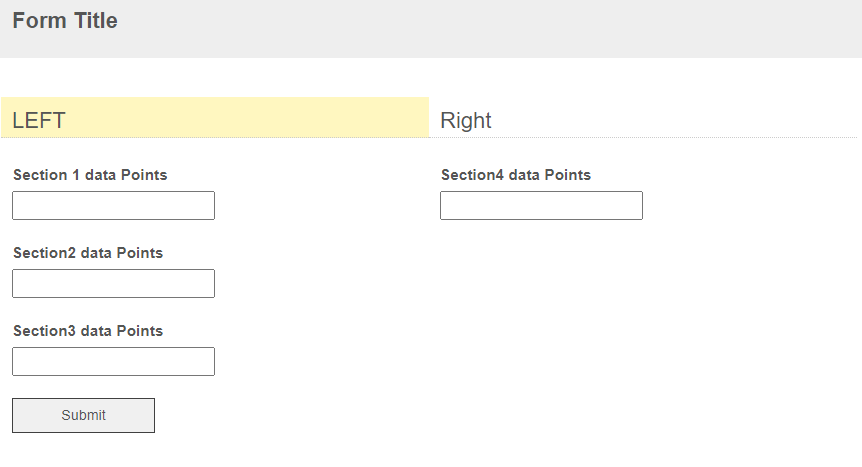

Ah, I see.
It's the sections causing your issue, it is my understanding that nesting sections in classic forms is not doable.
Going to 2 sections Left and Right and putting the associated section data into those two areas would work.
Ex.
Maybe use some custom HTML Fields to make the Headers for the "Sections". The one issue you lose by not being a section is the ability to expand/collapse the fields.
Just a thought.
Hi Troy.
Thank you for your response.
Before seeing Zachary's  response that's the way I went and got sort of a look I was looking for.
Much appreciated.
