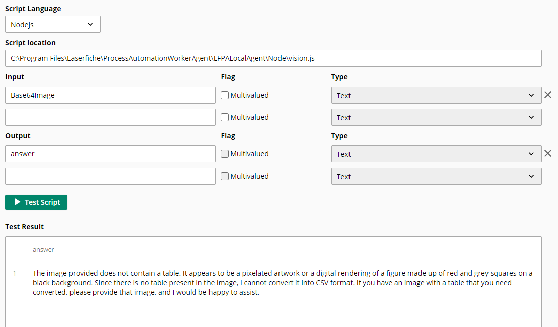

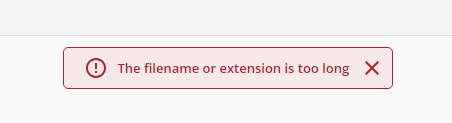

I keep getting this error when running my script rule in Cloud. I get the same error through workflow or just using the test option. It seems to happen when I reach a certain amount of characters in the input, Base64Image, but I don't see a character limit here and this would not be a file or extension.
It works if I use a shorter input string
Then as I try a longer input I get the error
Update: So far I have tried different random string sizes and found that I can send a 24,000 character string consistently. So I tried sending 5x <= 24,000 character values but still get the error. There is some file process happening under the hood of Cloud we can not see.
replied on August 16, 2024
Under the hood, the Node.js script is being run by System.Diagnostics.Process and the input tokens are passed as command line arguments.  Unfortunately, System.Diagnostics.Process limits the length of the command to 32767 characters, so presumably, your base64-encoded string is longer than around ~32600 characters.  I was able to reproduce the issue you're encountering with a normal string that was over 32600 characters long.

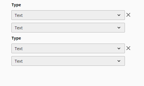

I tried sending a file to the agent but the type drop down forces a Text type on all script rules and that is why I ended up going with Base64 instead to begin with.

Here is what it looks like when I try to set the type:
I guess the agent was meant to work with very small chunks of data at a time
Correct, I don't believe this was an intended (or even imagined) use for the input parameters.  You'll need to find a different way to retrieve the data from the script (e.g., local file on the remote agent, web request, or LFAPI).
