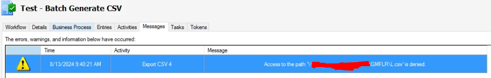

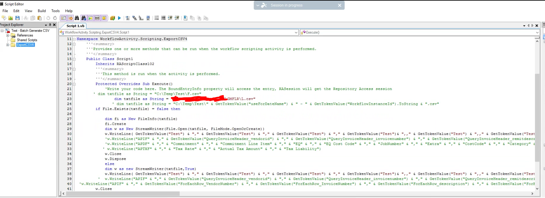

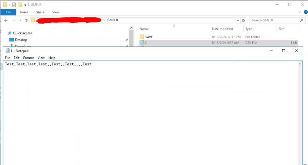

I have a Workflow with an SDK Script that generates a CSV to a Network Location. When I test the Script in the Script Editor, I am able to save the CSV, but when I run the actual Workflow I get an error that the path is denied. I am logged in as a user named Laserfiche, and I can access the folder. And the Workflow Service is running as the same Laserfiche user. So why wouldn't it be able to save?

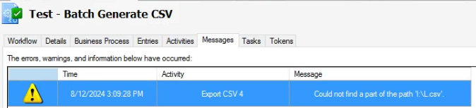

I have also tested it with the location mapped to a drive named "I." Again, I can save the CSV in the Script Editor, but when I run the WF, I get an error. This time, "Part of the path was not found."

The path has to be accessible from the perspective of the Workflow Server's service user. Services do no have access to mapped drives, just local drives and UNC paths. The "access to the path <path> is denied" error likely indicates that your Workflow Server is running as Local Service and can't access the network. Running it as Network Service or a domain user with rights to the remote location should clear that up.
Because the Designer (and script editor) runs as a Windows application rather than a service, it can access mapped drives available to the currently logged in Windows user.

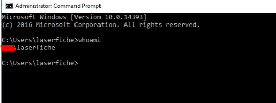

I mentioned that the Workflow is running as the same user I'm logged in as and posted an image of that service, so I don't think that's the issue, unless I'm missing something.

I am working with Chris on this and like he said, from the screenshot at the bottom of the original post, the workflow service is running as a domain\laserfiche account.  The screenshot shows that service user and the whoami showing the same user.
