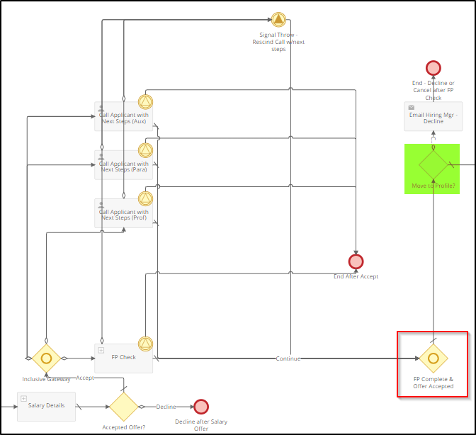

I am trying to salvage an instance without completely restarting. I have a few instances showing "In Progress", but actually stuck on a completed inclusive gateway step.  Restarting a previous task does not help the situation due to the setup of the gateway.  I cannot restart tasks prior to the gateway since they are in a sub process. I have seen some posts where users have updated cf_bp_worker_instances and cf_bp_worker_instance_history.  I wondered if adding a row to these for the next step (exclusive gateway) might work.  Any other thoughts on how to get an instance unstuck?
Backstory if interested - Process that began acting strange after a Forms update, currently running Laserfiche Forms Professional Version 11.0.2311.50564.    It undoubtedly needed to be cleaned up even prior to the update.  In haste, I have cleaned up the process and now dealing with the fallout of those instances starting previous to the changes. Gateways went from parallel to inclusive...  Lots of lessons learned here, just trying to get out the mess now. indecision

What are the current gateway rules?  Usually with a Gateway there is more than one path for the form to go but this looks like it goes to Move to Profile no matter what, so it seems a little unnecessary.
Were the ones that are stuck now previously on the parallel?  Sounds like it might be wanting to merge, and that option may have been removed.
replied on August 7, 2024
I want the process to wait to move on to "Move to Profile" until all active tasks within the gateway are complete.
The strange thing about the previous version - it had a parallel gateway start with a inclusive gateway end.  Not best practice, but it worked for years untouched.

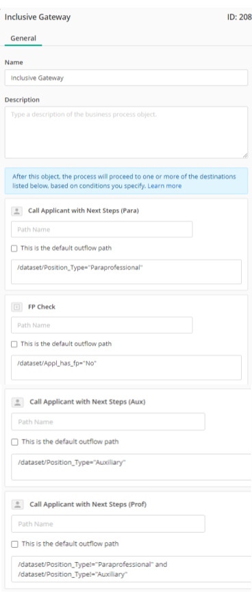

Can you show your gateway options?
In the subprocess of FP Check, you are waiting for everything in there to complete?

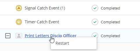

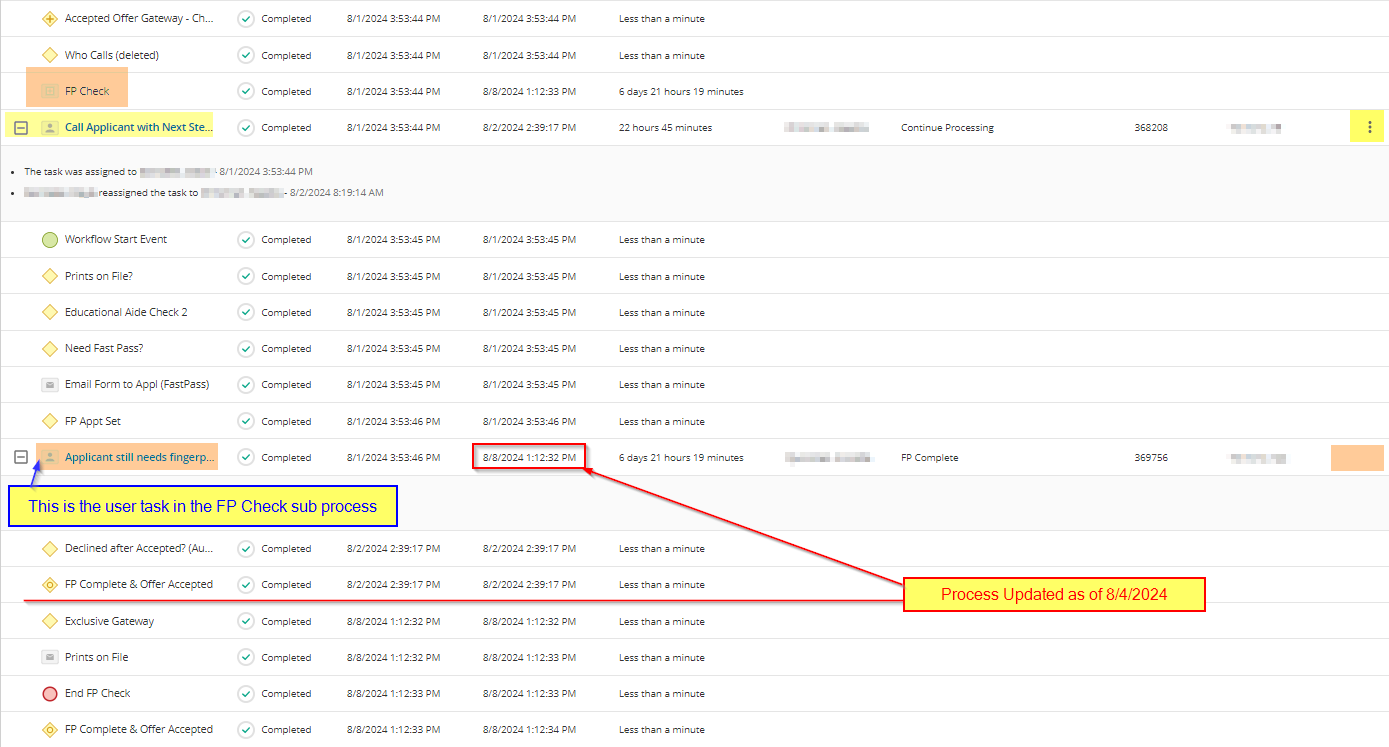

First I've heard of that restriction. Mind sharing a screen shot of what it that looks like from inside the instance when you try and restart? such as this:
Are there user tasks in the sub process? They would be the only step type that can be restarted.
replied on August 8, 2024
I've highlighted in orange the sub process user task.
I believe the biggest issue is the change in process from when the (prior) parallel was in place to the now inclusive gateway.  I'm just trying to find an easy way to force these to the next task instead of completely restarting 15+ instances.

got it. What do you see when you right click on one of those user tasks?
replied on August 8, 2024 Show version history
Call with Next Steps, I see restart.  Applicant still needs prints, nothing (other than web browser options i.e. Open link in new tab, new window, etc.)
