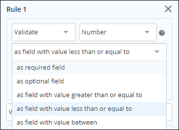

If they are using the Classic Designer, then the version isn't going to matter, it's going to be the same either way, and it's going to require Javascript.
If they are using the Modern Designer, then I think it might be worth pushing to get upgraded to gain the extra functionality recently added to Field Rules.  I could be wrong, and this functionality was already in place on Forms 11 Update 3 (11.0.2212), but I feel like it didn't come until either Forms 11 Update 4 (11.0.2307) or Forms 11 Update 5 (11.0.2311).  You can set Field Rules to validate a field above, below, or between specific values or values from other fields.  As you mentioned, you would likely still need to include a second (possibly hidden) field to calculate the limit of the start + 800 miles, but that field could be used in the Field Rules to set that limit on the main field.  It's a fairly easy, no code solution.
