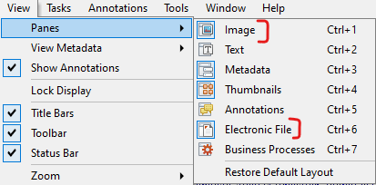

Can you confirm that the documents in question have pages generated?
Typically, when our users get this message, it is because they are looking at a document that only has an electronic file, like a PDF, with no pages.
In those instances, it would depend on their display settings since electronic files and pages are shown in different panes.

replied on July 25, 2024
Can you confirm the client settings? A screenshot of the same menu I included would help verify which panes you're seeing.

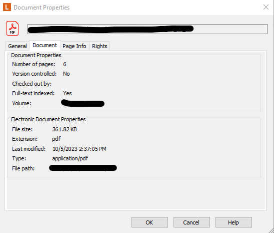

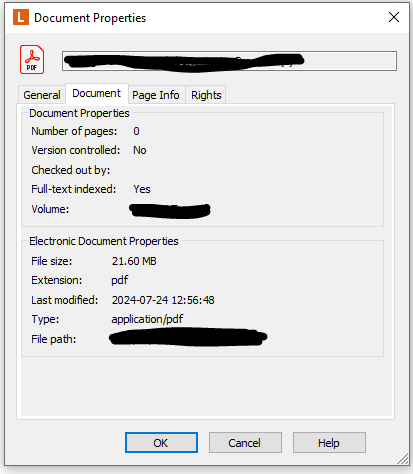

That is very odd. Can you right-click that entry and open the Properties window, specifically the Document pane.
Yes, I can right click on the entry
Are you certain that the two users are looking at the exact same entry ID, and not something with the same name but that isn't actually the same entry. I wonder if they are looking at two different entries and with one the pages didn't get imported correctly. In that dialog you opened above, you should be able to see the exact unique EntryID in the General tab. Please confirm they are the same for the entries both users are looking at?

Adding to what Pava has already mentioned,
The screenshot confirms there are no pages in that particular document, so the "no images" message is to be expected, but it does have an electronic file.
