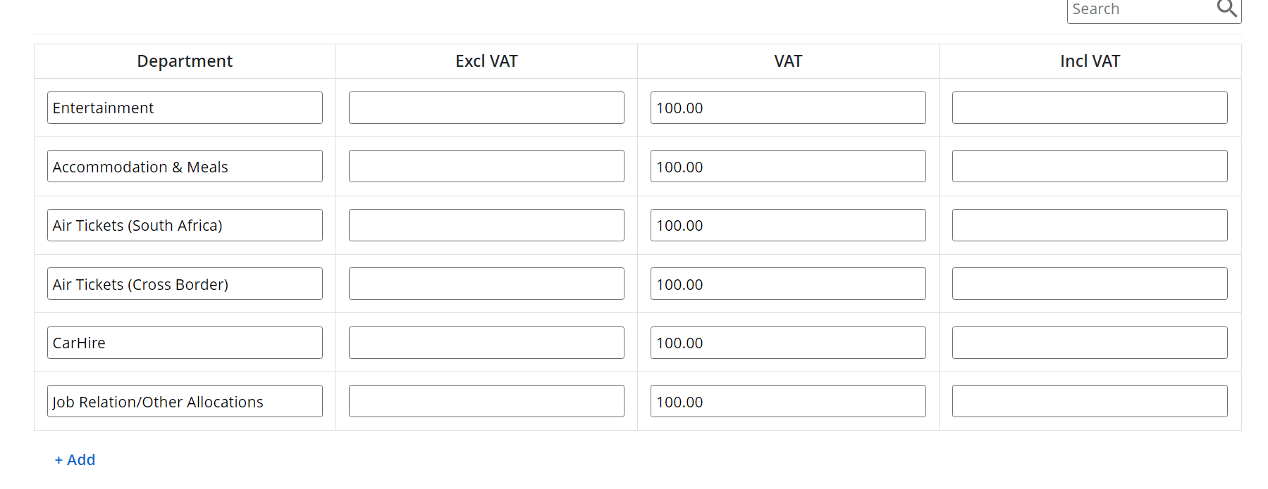

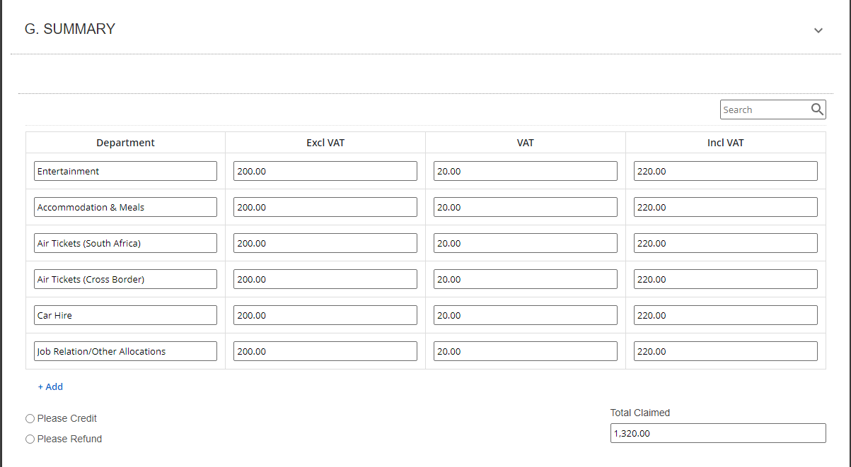

I would like to ask for assistance i have a different table that have information for different departments and at the end i have a summary table that need to have the total vat and including vat so i need to calculate those values but the problem is i am using a lookup to populate the different departments in the summary

i am using a lookup rule to populate the summary departments when i run the form therofore it is not possible for me to be able to add different calculations for the other  columns hence there if you can check the value in the summary table are all the same so i need to have the total excl vat ,VAT,Including vat for each section as you can see in the summary table

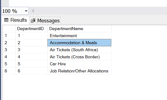

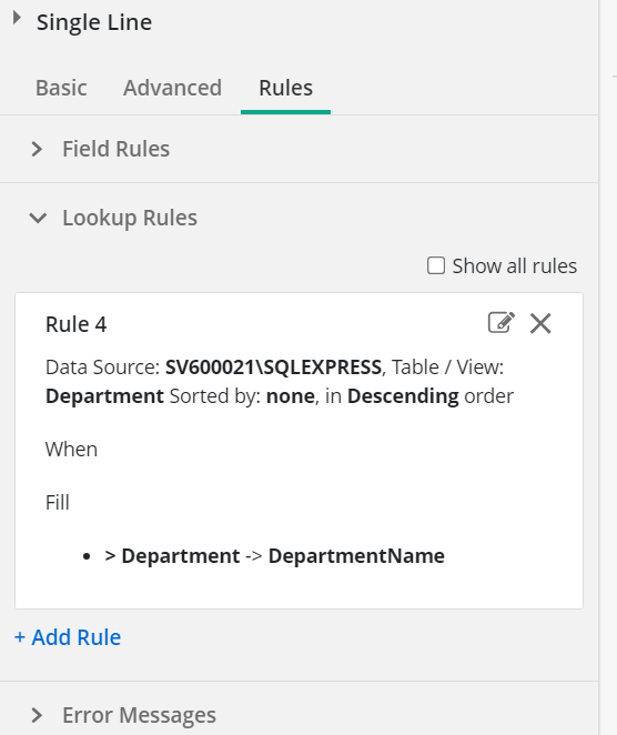

Hi Antony, can you show how is the look up rule designed?

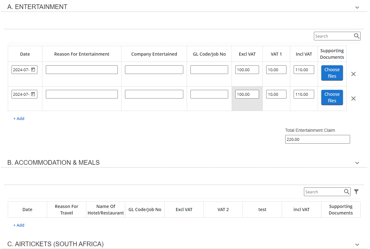

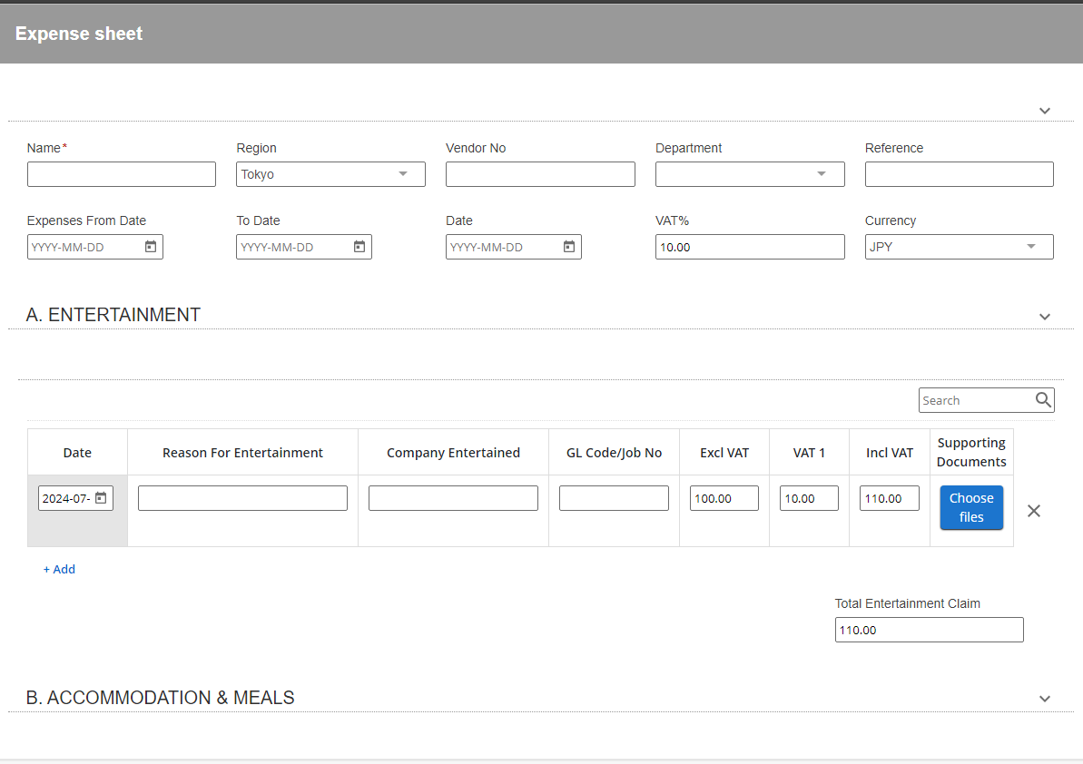

we are populating the department with values on the lookup table.So the idea is to have the total values for specific departments  being displayed at that particular department in the table because we have already calculated the the totals in the previous sections tables per department .if you take a look at the images that have posted you will see the tables have all the data that we need to use for the summary table that has all the departments
replied on August 8, 2024
The lookup rule on Department field looks good to me, but it seems that other fields in the table should populate value based on different Department selected, so you need another lookup rule to populate these fields based on department. Is this your question?

yes you are right i need to populate according to the department selected but now   those spefic department to need to be populated by  the the data in the above tables e.g Entertainment so when i click add a record on the entertainment i want t the total and the other information on that spefic department to be added on the summary table

Than you Gavin. I have tried to use the formula that you suggested i should use but it seems to print the same value in all the columns.i have posted the images that shows the results.here is how i tried to implement the formula
=IF(EQ(INDEX(Table_Summary_section,ROW()),"Entertainment"),Total_Entertainment_Claim_Excl_VAT, IF(EQ(INDEX(Table_Summary_section,ROW()),"CarHire"),Total_Car_Hire_Claim))
