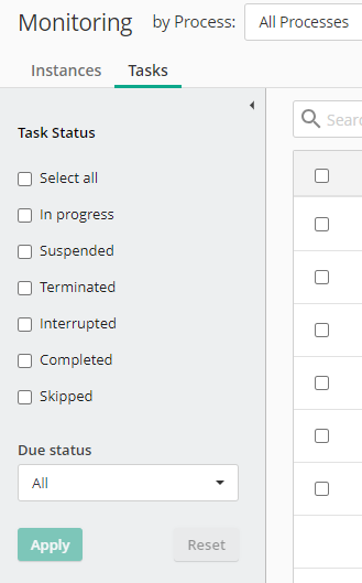

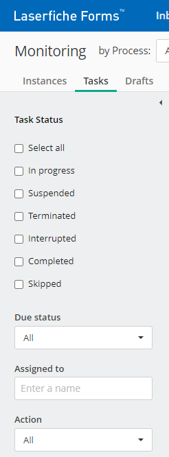

replied on July 25, 2024
We're still using 10.4 for our main portal and I can't seem to figure out if there's a way to view a user's LF inbox or to search the whole of Monitor for tasks assigned to that user.
I'm not entirely certain about 10.4 as I haven't used that in a while. That said, on the current version, there is a "Tasks" tab in the Monitoring section that will allow you to filter all tasks by who they are assigned to. From this section, you can also perform reassignments by checking the boxes of the tasks you wish to reassign and clicking the "Reassign" button in the top right.
That feature also exists in 10.4, although you can't search by user or even change the sorting order. I checked to see if the element was just hidden in HTML to double check but yeah, just not there for 10.4
