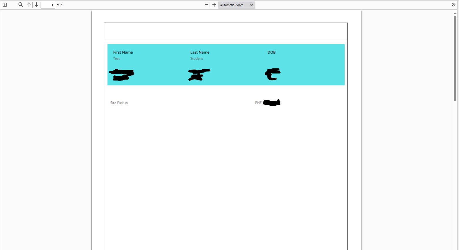

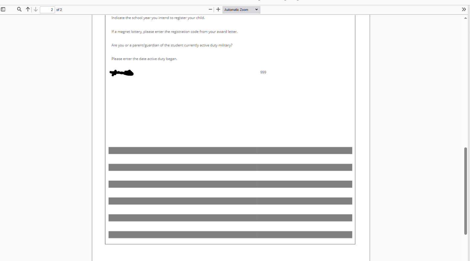

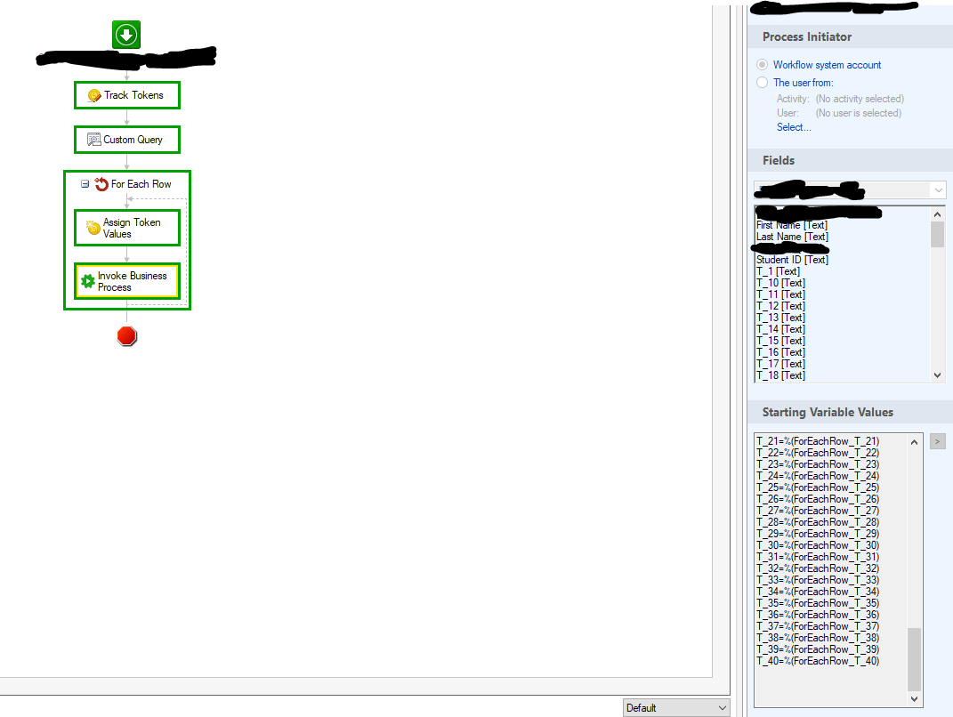

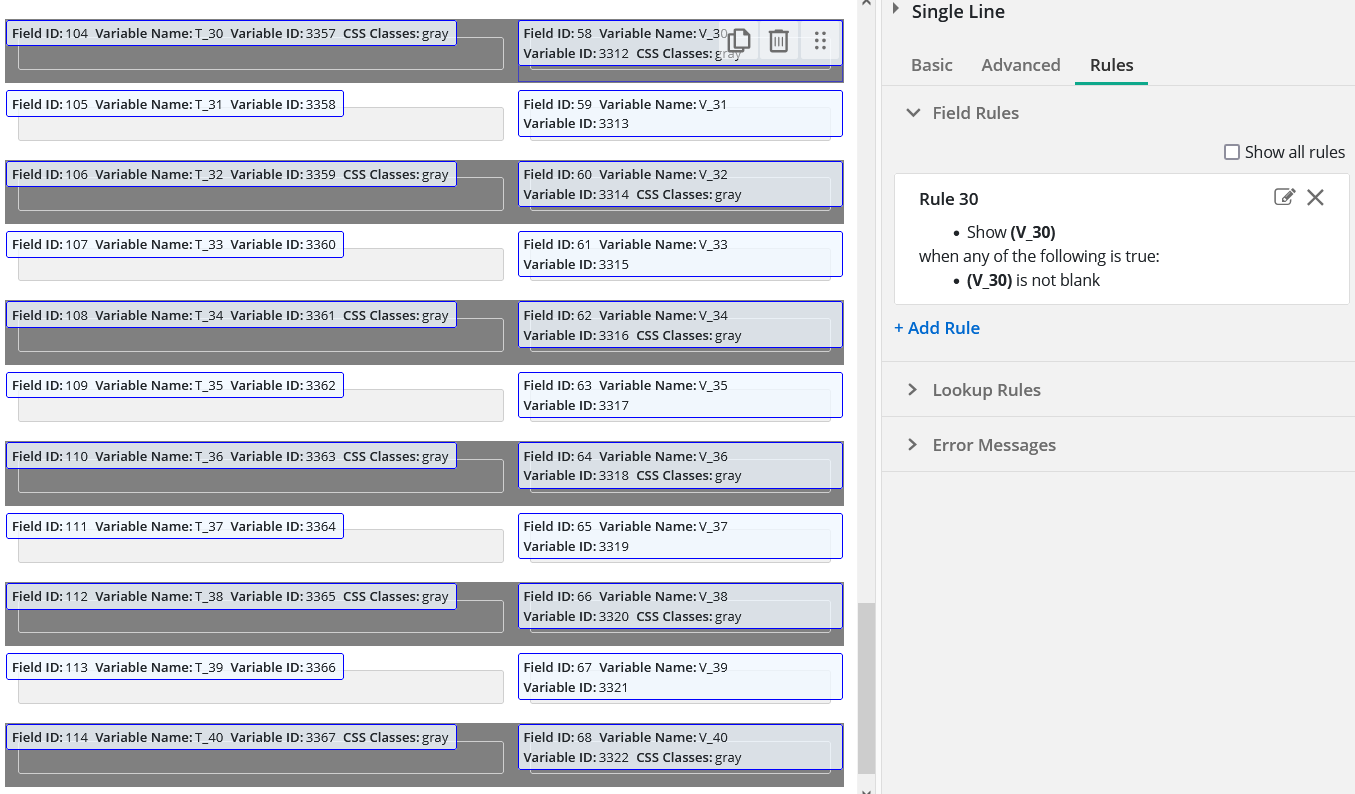

If you use a workflow to invoke a business process, and the variable populations are blank, they will not be treated as blank by field rules present.

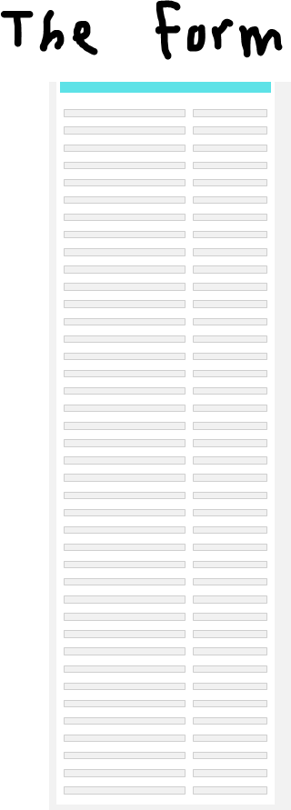

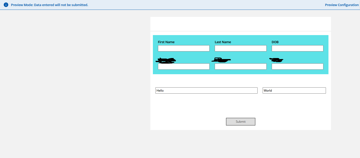

I originally thought that the CSS was being ignored by the field rule when invoked by a workflow, but after further trouble shooting, I saw that there was a very large amount of white space inside of my form when placed into the repository. This white space is actually my single line values that were supposed to be removed from the form with the field rule I attached below.
It seems like Laserfiche forms can't recognize a field as blank if it was populated with a blank value from a workflow.

could you post a screen shot of your field rule? I will test this out on my end too
replied on July 23, 2024 • Show version history
When attempting to redo the bug I realized I was wrong on what was causing the issue. Thank you for looking into it, it seems like the issue lies between how Workflow interacts with Laserfiche forms.
