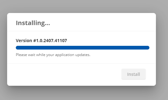

I am trying to update from Version 1.0.2405.41202 to Version 1.0.2407.41107.  It starts the update but does not finish.  I have attached a screen shot of where it freezes.  I have tried in both Chrome and Edge.

Hi, Bill, please try the following to use the new version of the Assessment Tool.
  1. Open the folder %temp% in Windows File Explorer.
  2. Search for LaserficheAssessmentTool.exe, open the latest folder named by GUID, make sure the file version is the 1.0.2407.41107 (right-click -> select Properties -> Details tab -> File version), and then double-click to launch it.
  3. If new LaserficheAssessmentTool.exe still does not run after the above steps, please remove the legacy Assessment Tool first by following steps.
    1. ⁠Open Task Manager, find LaserficheAssessmentTool.exe, right-click and end task.
    2. Rename the Assessment Tool in the folder %LocalAppData%\Laserfiche\Assessment Tool\bin, e.g. LaserficheAssessmentTool-rename.exe.
    3. Launch the latest version of Assessment Tool again.
To address the issue for future updates, would it be possible to provide the error logs in the folder %LocalAppData%\Laserfiche\Assessment Tool\log?
