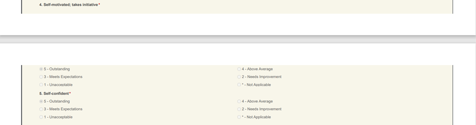

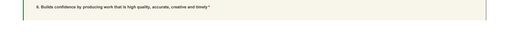

I have a personnel evaluation Forms process that I've added an email activity to so that users can request a copy emailed to themselves (they like to have a printed out copy when meeting to review the form).  Unfortunately, there is information that does not appear on the emailed form and I'm not sure why.  And yes, I can appreciate the irony of the one question on the entire form where the information is missing!  Notice that for question 6 the final line of the radio dial button options is missing.  This is not the case when the form is viewed inside the user task.
Screenshot of bottom of page 2 of emailed pdf and of top of page 3 of emailed pdf:

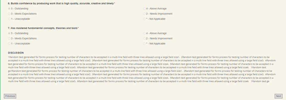

Screenshot of same form viewed as a user task:

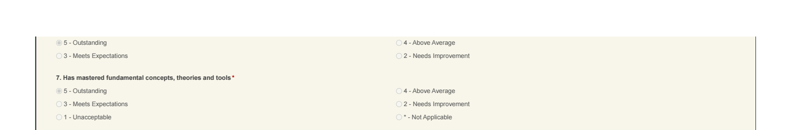

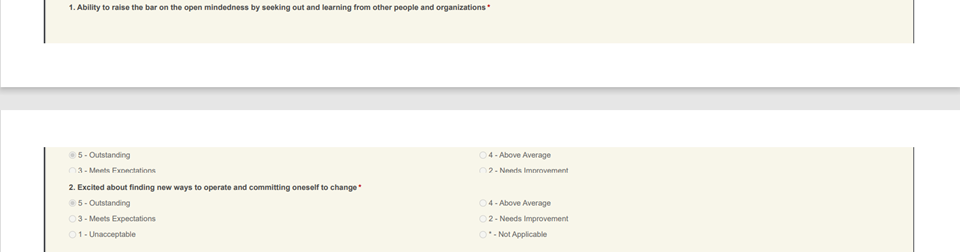

UPDATE:  This occurs fairly consistently with questions that have radio dial button answers and appear at the bottom of pages on the emailed pdf.  If a question appears VERY close to the bottom of the page things work properly; however, if it appears far enough from the bottom of the page that the first line of radio dial buttons should fit, they are forced to the following page and the final line of radio dial buttons does not appear on that following page.
Note space between question and end of page along with missing data on following page:
Note less space after question and data on following page is intact:

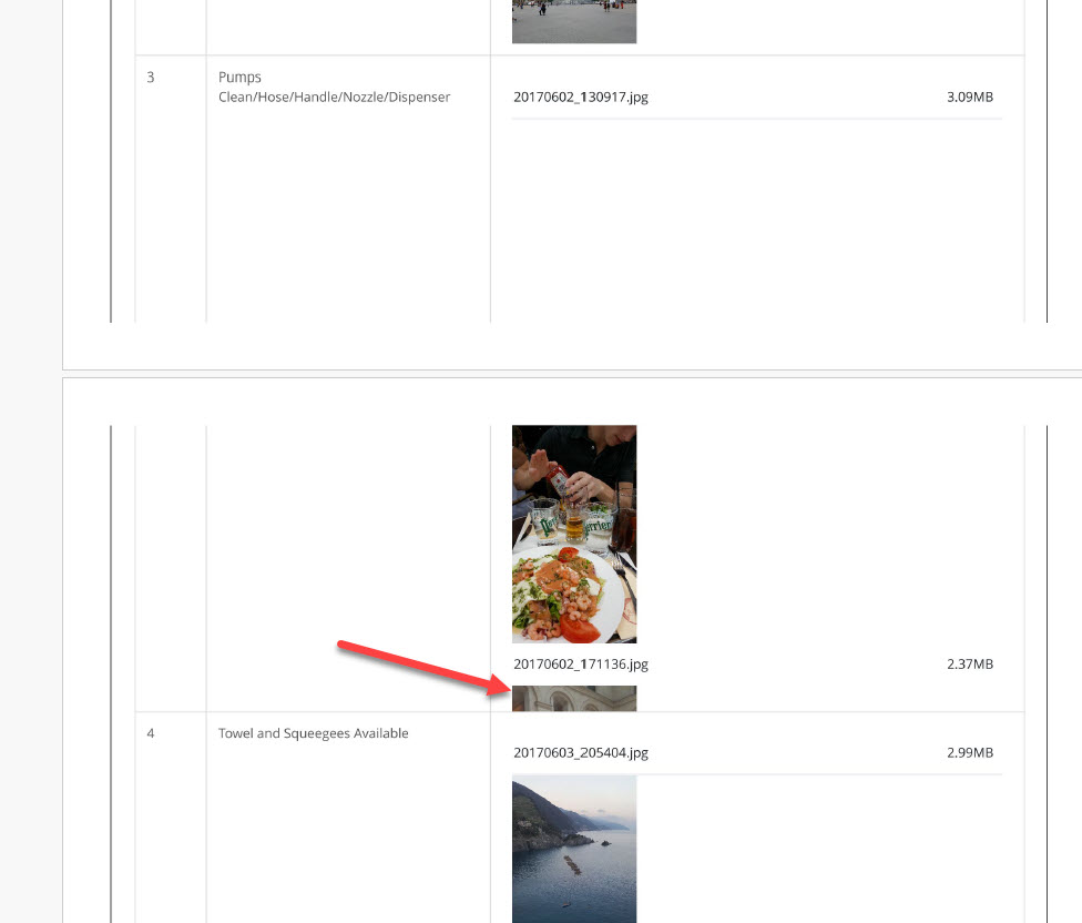

I am having a problem with pictures that are uploaded in a table that has a few rows (2 picture uploads allowed in each row), and I am having an issue with pictures getting cut off when they overlap pages. While searching for a solution, I saw this post and thought that I would piggy-back on it. I am using Laserfiche forms version 11.0.2311.50553 and using forms designer.
