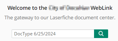

We have a template that has a DocType field and a DocDate field.  Documents with this template are available via WebLink and are searchable via custom searches pointed to those two fields.  The customer is requesting to be able to put multiple values into the main search bar (like shown below) and have it pull back documents that have fields with either and/or both values filled in to any metadata.
Right now, putting either of those individually in, it successfully pulls back documents.  However even though there are documents that have both, nothing comes back when both are put in. I understand that the underlying issue is that WebLink is using Laserfiche search syntax and that does not allow for searching for different terms across the fields.
As this is public facing, the customer is wanting this search box to function like Google where people can put in various data and it return the relevant results across all data associated with a document (metadata, text, name, ...).

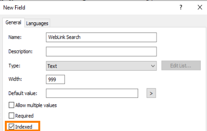

In the meantime, I am thinking of a few options:
1) Creating a large template field that holds all the document's metadata
  • Create an indexed field & populate with metadata
  • Have Workflow write the key metadata into there, separated by white-space
This would be the easiest of the options but I am not sure how Laserfiche searches these indexed fields via the Quick Search toolbars.  Does it treat them like OCR text when it searches Indexed fields or are the searches the same for all fields no matter what?

For those who run into this issue, option 1 above did not work.  The Workflow properly updated the new indexed field, the index service updated the index, but the quick search bars in WebLink and WebClient still searched it like any other field.
