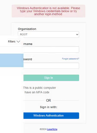

Hi everyone,
A customer is having an issue that prevents them from using LFDS to log into Forms using their Windows credentials. Has anyone seen this before? I found an instance from March 30, 2020 but my scenario is using a single STS site, situated on on the LFDS server. For the record, I have Repo and Web Client on their own servers within the same domain.
Clicking on the Windows Auth button just generates an error to remind me there's a problem.

The first thing I'd check is whether this STS instance was configured to use the "Alternate Service" even though it's on the same machine as LFDS (where it's unnecessary). STS does not support WinAuth in the Alternate Service configuration.

Hi Samuel: I considered that but when I configure the "Alternate Service" the "Windows Auth" button isn't visible. Also, Windows Auth gets disabled in lfdssts/configuration

Okay, I didn't think the Win Auth option showed up in the UI when the Alternate Service was enabled but figured it was worth checking. Definitely file a support case.

You can also check IIS and ensure Windows Authentication is enabled under the site.

The Authentication was set to Windows. After chatting with support, I've requested an updated certificate because the SAN of the cert didn't list both FQDNs of the A-Record and CName of the server.  The SAN isn't wrong it's just incomplete.

So I have a resolution but only partial answer so far.
Putting the FQDNs of the a-record and CNAME in the SAN didn't resolve the issue.
Setting up the LFDS and LFDSSTS endpoints to use the FQDN of the a-record and not the CNAME did work and fixed the problem... but I still don't know why using the FQDN of the CNAME didn't work.
replied on July 8, 2024
Almost certainly a Kerberos issue that resulted in a blocking failure due to NTLM being disabled so it couldn't be a fallback.
A DNS CNAME alone does not set the necessary Kerberos SPNs for Win Auth to work with an alias. Try removing the CNAME record and then setting a Computer Name Alias instead, which will handle both the DNS and Kerberos side of things.
