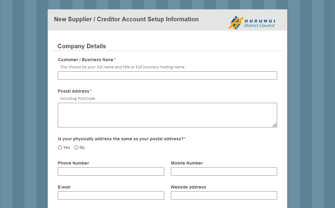

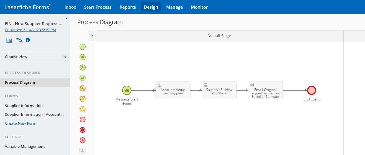

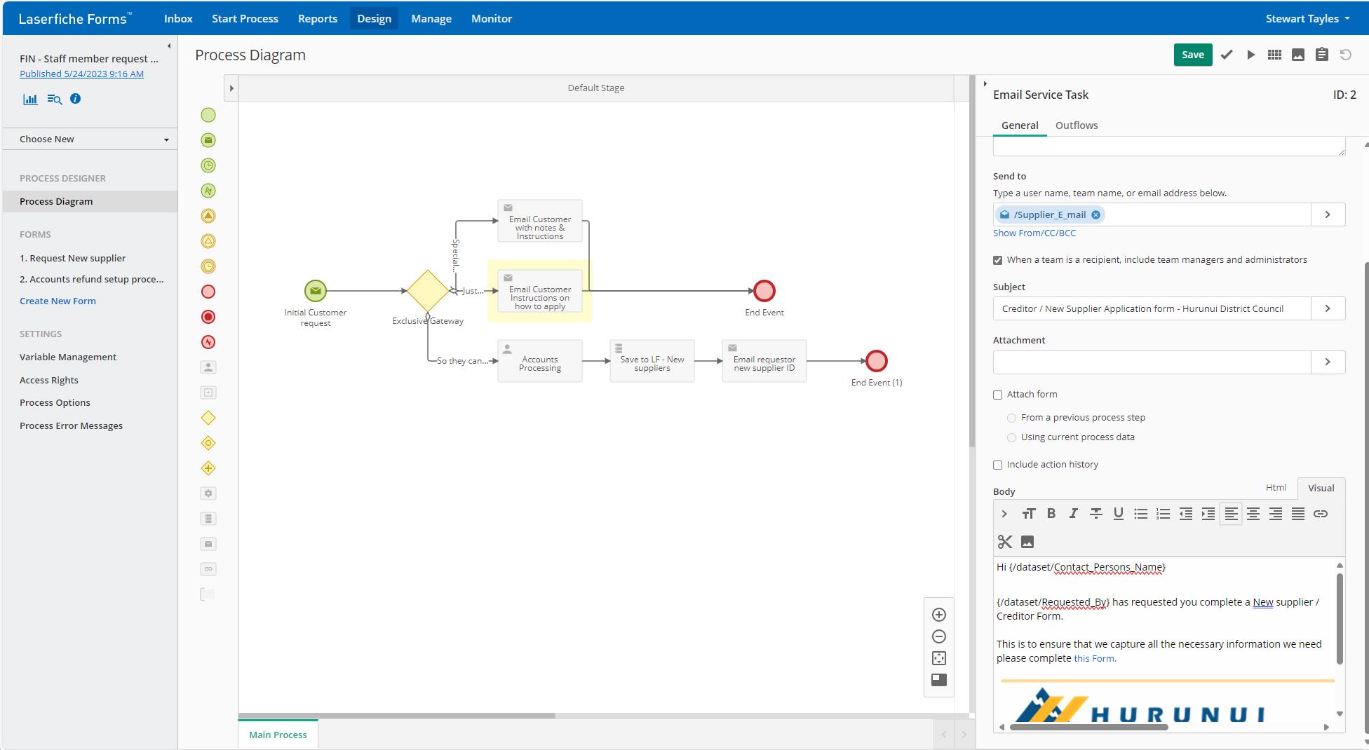

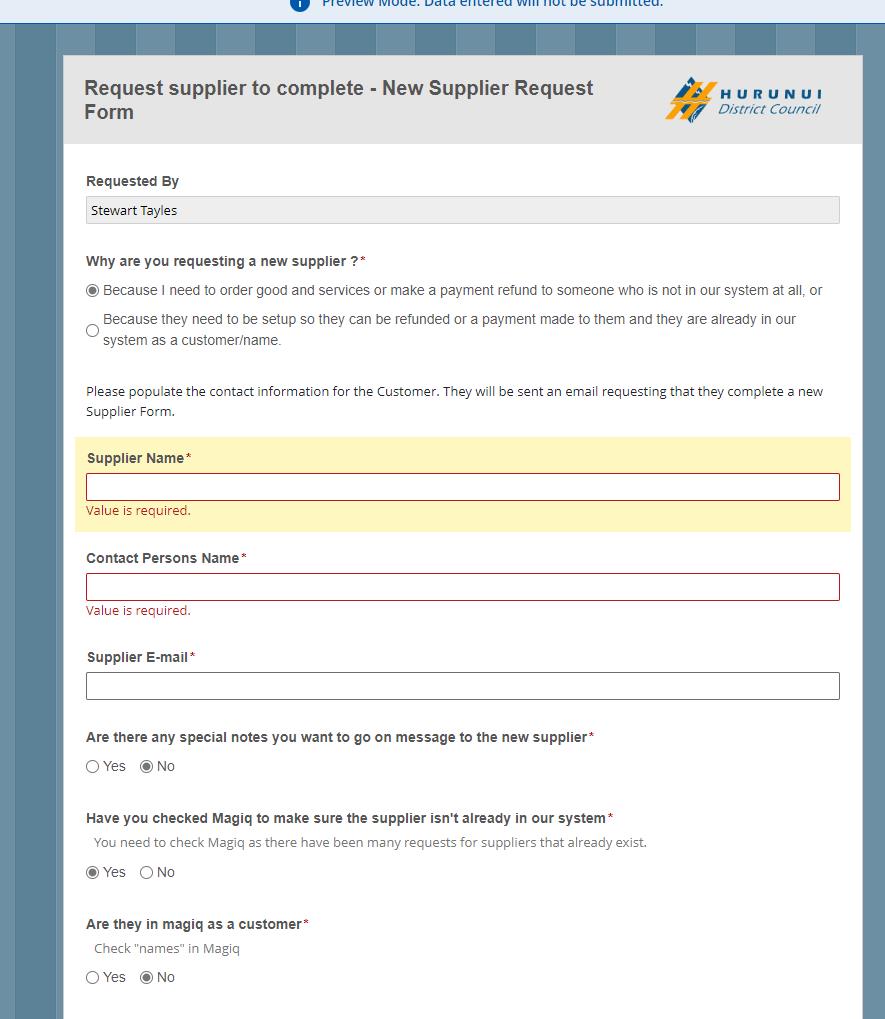

Hi Luis,
A little bit of background context. We have a new supplier Form. For security & compliance reasons, we want the process to be initialed by an employee. This Form also has a bunch of prompts to ensure the supplier doesn't already exist.  Lets call this Form1, and it is a restricted form. at this point we capture key supplier information.
The challenge we had was our suppliers don't have a Laserfiche Licenses, so they can only initiate a new process. Our solution was to create a second process that the Supplier starts. Lets call this Form2
To initiate a supplier to complete the process, After Form1 is completed, it emails the supplier with a unique URL for Form2 that includes parameters on how to apply to be a supplier. The URL includes
  • which internal staff member started the process, (variable=R)
  • the requesting instance ID (variable=RID)
  • and the Internal CustomerID, if it exists. (variable=CustID)
Refer to the Code below.
https://laserficheFormsServer/Forms/xxxxx?R={/dataset/Requested_By}&RID={/dataset/_instance_id}&CustID={/dataset/CustID}

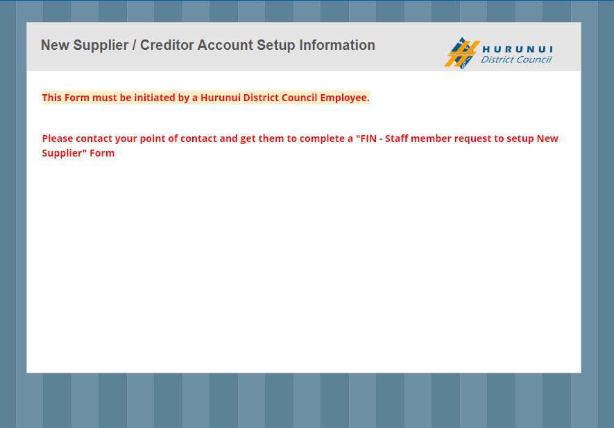

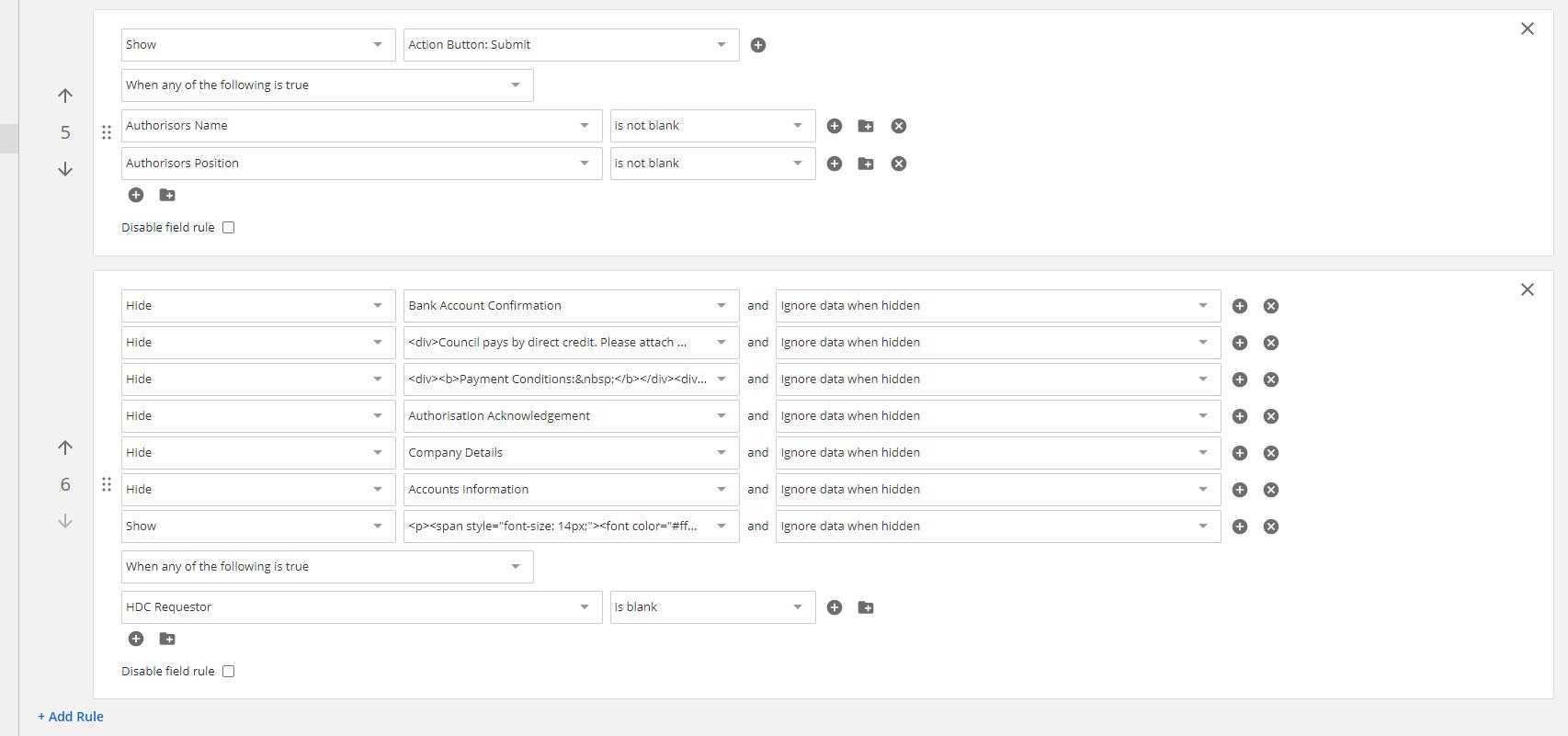

On Form2 these parameter Fields are hidden, but the data is always saved. In addition to the data we want a new supplier to complete there is a CustomHTML element that has a disclaimer that this process must be initiated by one of our employee's and if the new supplier wishes to be a new supplier, to contact their point of Contact.
Form2 has a field rule, that looks at the prepopulated parameters, and if they are emtpy, shows the CustomHTML and hides any input fields.
This is a summary, as there are a bunch of other notifications and user tasks required, but the reason for passing some of the addititonal information to make the accounts team life easier and to also notifiy the initial requestor when the new supplier setup is complete.
I have attached a few screenshots which should help visualise whats happening.
