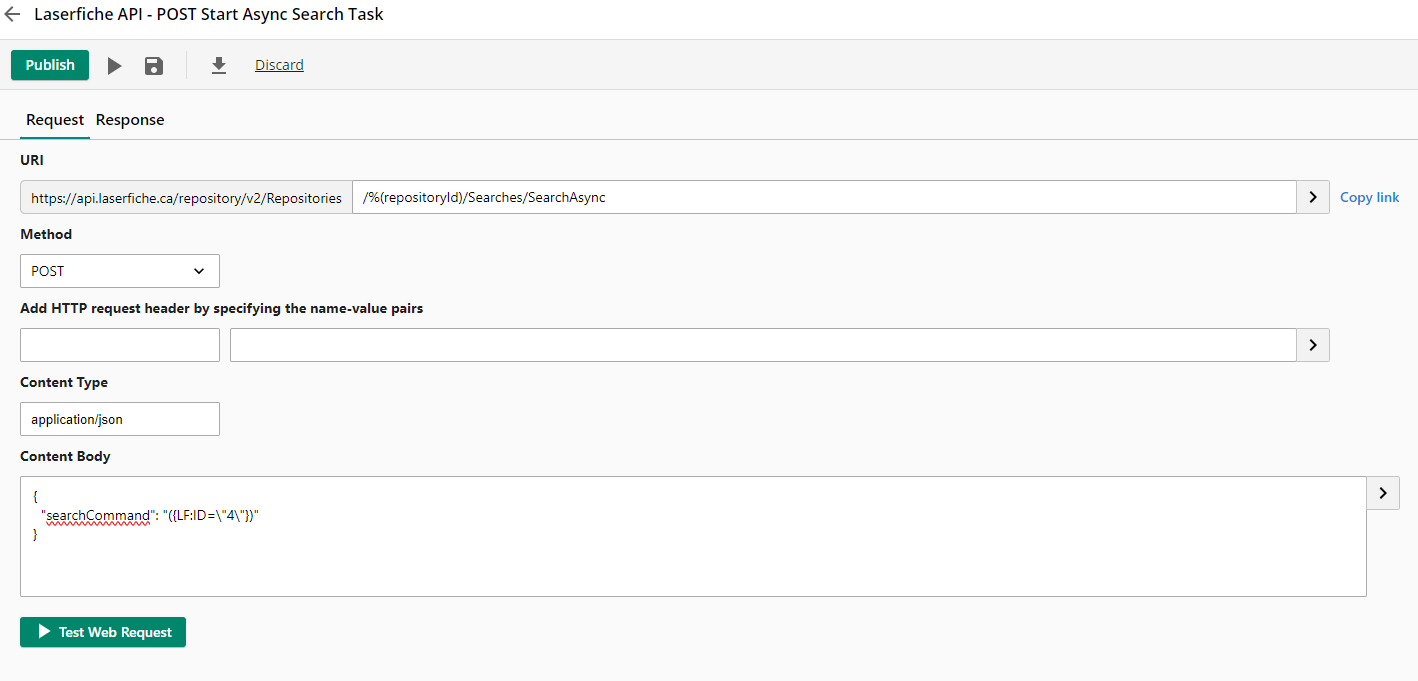

I am trying to start a search task and then retrieve the results using the Laserfiche API.
This is my POST request which starts the asynchronous search task:
And this succeeds and returns a taskId:
202
  "@odata.context": "https://api.laserfiche.ca/repository/v2/$metadata#Laserfiche.Repository.StartTaskResponse",
  "taskId": "82a5dbf1-073d-4fd8-8c6a-61a9fe513832"
EDIT: It returns a 202 response but it also returns a location URL (ex: https://api.laserfiche.ca/repository/v2/Repositories/r-0001/Tasks?taskIds=9e18b8b2-5486-41dc-99e7-69bf34f524f6) and in this URL it actually says:
{"type":"accessDenied","title":"Error: Invalid or expired access token.","status":401,"instance":"/repository/v2/Repositories/r-0001/Tasks","operationId":"478c3c68079b435fa28749a2e344df72","errorSource":"Api Server","errorCode":201,"traceId":"00-e4013d8c132147dd521435a9cb3d43e4-66466f83a9298503-00"}
So it's actually failing but in the Web Request response page it shows 202.

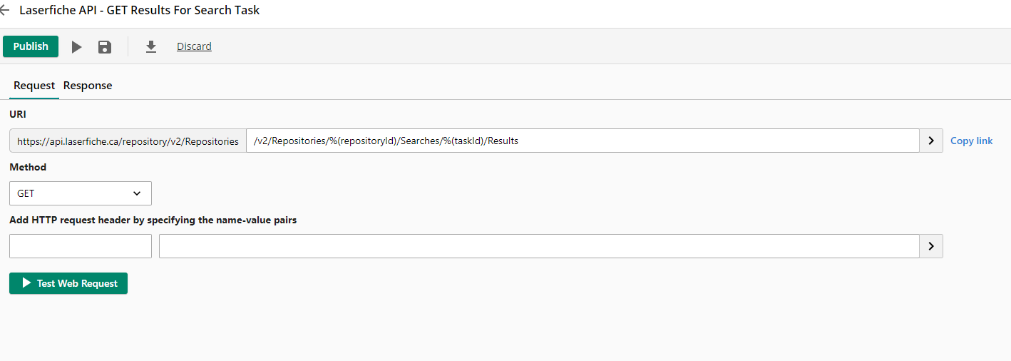

replied on June 20, 2024
Your URI looks incorrect in the screenshot for the GET request. You have "/v2/Repositories" in it twice.
replied on June 20, 2024 Show version history
Good catch, thank you. I still have the same error though.
Edit: I tried to run this again from the start and it worked. That was simple enough thanks!
