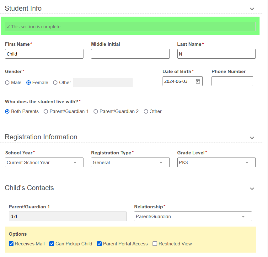

I have a Registration Form, you can register 6 children for school on the form. In a situation where a reviewer wants to approve each child individually instead of as a family, a workflow splits the Registration Form by calling a "Child Correction Form" up to 6 times with each individual child's information as what populates the Correction Form on each Business Process Invocation.

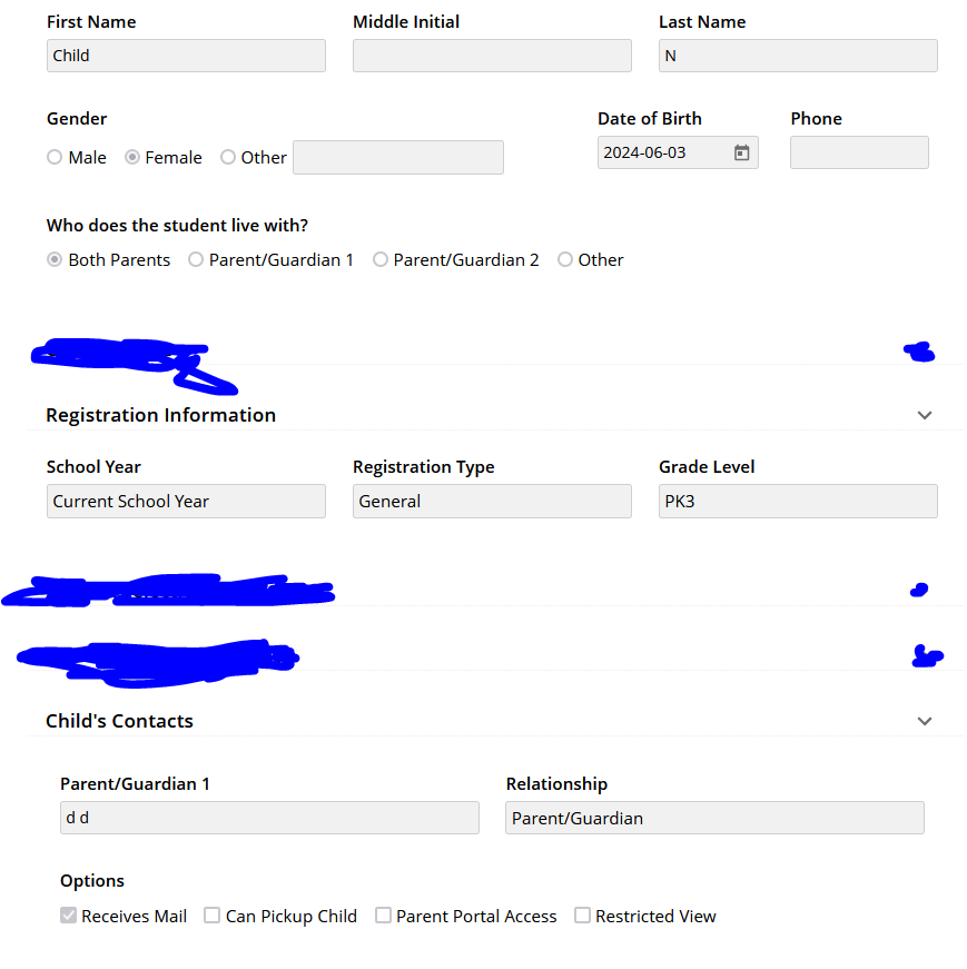

I finished the main functionality of this but noticed that for parts of the form that had the "Checkbox" field in forms, workflow would not properly populate the Correction Form. The Correction Form would only ever have 1 checkbox filled in, instead of however many the Registrant filled in.
(See Example below)
In workflow you can access the boolean value of each individual checkbox of a checkbox field, but you cannot access the fields themself  on the Business Process you are invoking. Therefore I cannot individually populate the boxes of a checkbox field through workflow.

Thank you for your reply! I should have added a bit more information. So originally I had done this, and assumed that it just worked. But then later when I was edge case hunting I noticed that this code snip would lose information.
correction_contact1_options=%(GrabChild1Values_child1_contact1_options)
To more clearly show what the issue is I attached before and after images below. Honestly I am starting to believe that this is a bug within Laserfiche.
