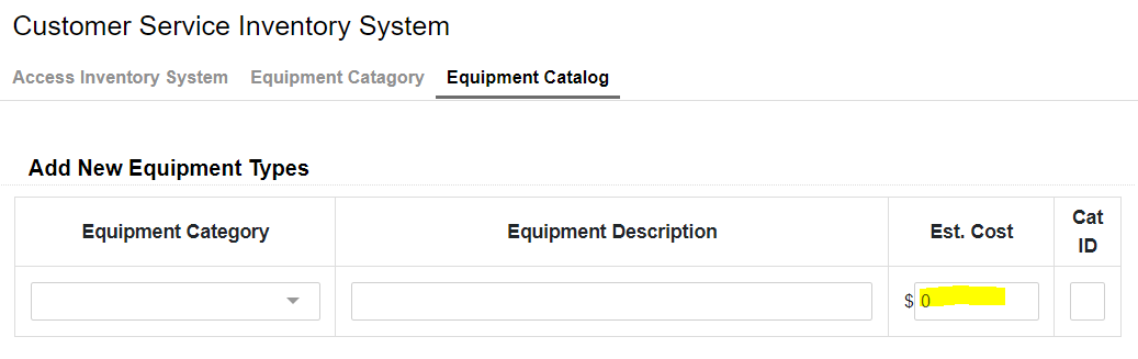

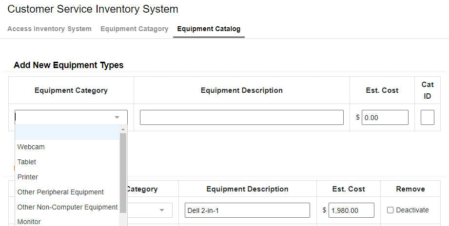

Has anyone else found the modern forms designer to have issues where fields will just stop working?  For instance, I have a form.  In preview mode, the form behaves as expected.

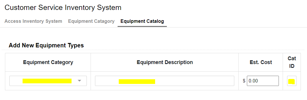

When I launch the live form, the same table comes up with three of the fields as read only as shown below.
If I click into the currency field, that field then becomes read only.
And... Just to add to my feelings of madness... on rare occasion, the live form DOES work as expected.
Sometimes when this happens, I can delete the variable and create a new copy of it and it works again, but another random field may then begin to start failing.

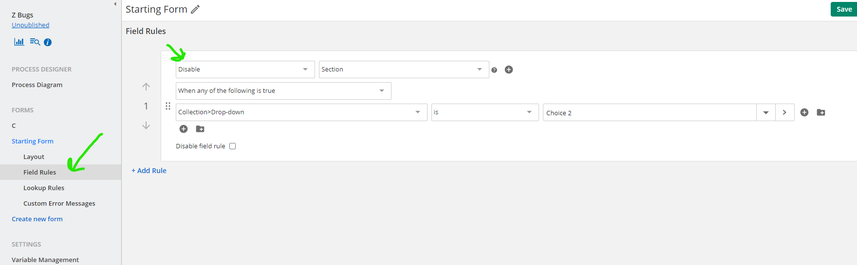

Unfortunately our documentation does not get much into troubleshooting steps, but this is something we're trying to fix! Here is the field rules page in our documentation although I do not think it will help here.
The term used in field rules is 'Disabled' as it only emulates readonly, you could skim your field rules for this term. It should look like this
