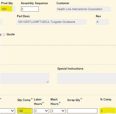

Good afternoon.  I am attempting to gather the percentage of the value of a Number field Outside a table by comparing it with a value inside the table and the writing the results inside the table.
Details:
Prod Qty is a number field with variable "Prod_Quantity"
The Table is called "My_Time" with (2) fields inside involved: Qty Comp & % Comp.
Qty Comp is a number field with variable "Quantity_Comp"
% Comp is a number field with the variable "Percentage_Complete"
The % Comp is the field that contains the formula:
=DIV(INDEX(My_Time.Quantity_Comp,ROW()) , Prod_Quantity)
Currently I don't get any errors, but the % Comp value stays at '0'.
If the math worked, I would get 0.2.  So, I would want to move the decimal over so it reveals '20'.

A couple of questions before I dig too deep:
Have you set your % Comp field to show decimals? If not, that is likely why it is still displaying 0 as it would round down from 0.2. Seeing as it's showing as 0 and not 0.0, I'm guessing this is the issue.
Alternatively, since you said you're wanting it to display as 20 (%) instead of 0.2, you should adjust your calculation to multiply by 100. (In this case you don't need decimals.)
If that doesn't help I can try and look into the formula itself, but I wanted to confirm these points first.
replied on June 12, 2024
That was the solution.  Then to get the decimal in percentage value, I just added the *100 at the end of the line.
