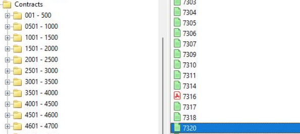

Users are dragging and dropping files to upload into Laserfiche Cloud. These documents usually show up as the default Laserfiche filetype.

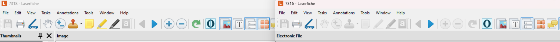

A newer user is doing the same process, but their documents are uploading as PDF and seen as a electronic filetype.
Due to this file being seen as a PDF, users are unable to use the following functions:
- PDF file cannot be combined with non-PDF filetypes in Laserfiche
- Several Laserfiche functions are unavailable for the PDF file vs non-PDF files
Laserfiche filetype vs. PDF filetype > Note the greyed out functions

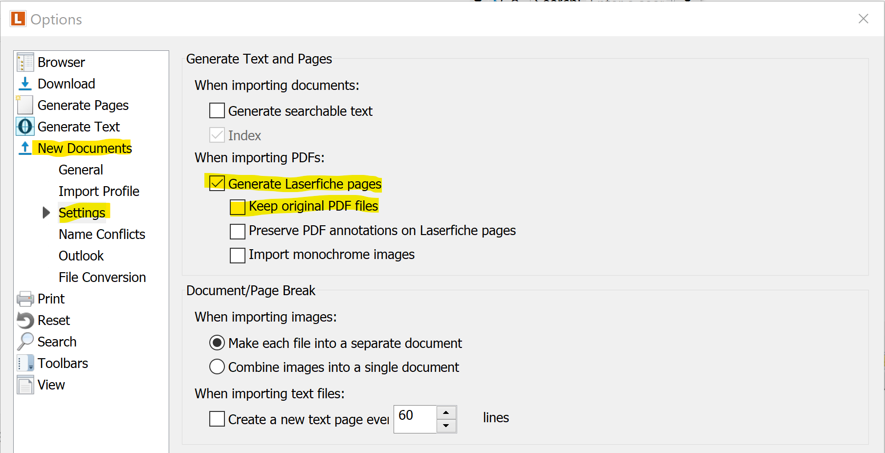

This should be in the user settings.
Tools > Options > New Documents > Settings
  • Generate Laserfiche Pages - creates TIFF pages from the PDF
  • Keep original PDF files - determines if the PDF is kept or discarded after page generation

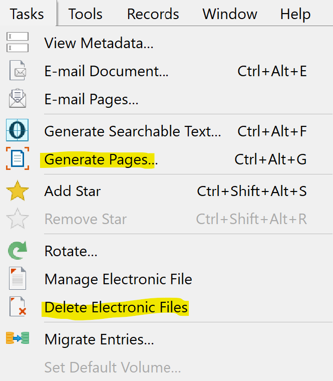

Yes, you can select the document in the client, then from the main toolbar the options you want are both under Tasks:
  1. Generate Pages - creates TIFF pages from the PDF
  2. Delete Electronic File - removes the PDF from the document entry
Automating this would be a bit more work; in Cloud I believe you'd need to use Quick Fields and it could be more work than just fixing them manually.

It looks like the user already has Generate Laserfiche Pages checked but Keep original PDF files unchecked. The user is still uploading documents as PDFs.
Do you have any suggestions for other settings I can check to prevent this user from uploading PDFs?
Again, thank you so much for all your help!
Terra Lane
replied on June 13, 2024 Show version history
Those two settings are 100% the ones controlling the behavior, so it sounds like their settings were changed after the fact or there's something else going on.
